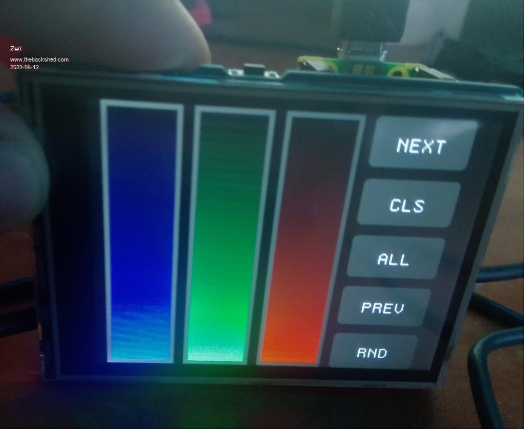

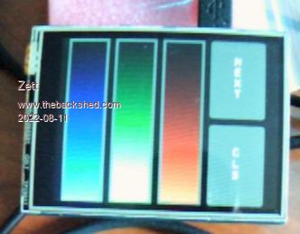

Hi ppl!,
I made some code to control a ws2812 leds(12ps)
Dim b%(11)=(0,0,0,0,0,0,0,0,0,0,0,0)
SetPin gp4,dout
Bitbang ws2812 o,gp4,12, b%()
Backlight 100
Colour &Hffffff,&H000000
CLS
groen=&h000000
rood=&H000000
For e=0 To 239
Line 10,e,70,e,1,e
groen=groen+&H000100
Line 80,e,140,e,1,groen
rood=rood+&h010000
Line 150,e,210,e,1,rood
Next e
uitlezen:
x=Touch(x)
y=Touch(y)
If x<0 Or y<0 Then GoTo uitlezen
If y<15 Then y=0
If x>10 And x<70 Then ledblauw=y
If x>80 And x<140 Then ledgroen=y*&H010000
If x>150 And x<210 Then ledrood=y*&H000100
ledkleur=ledblauw+ledgroen+ledrood
Bitbang ws2812 o,gp4,1,ledkleur
Loop

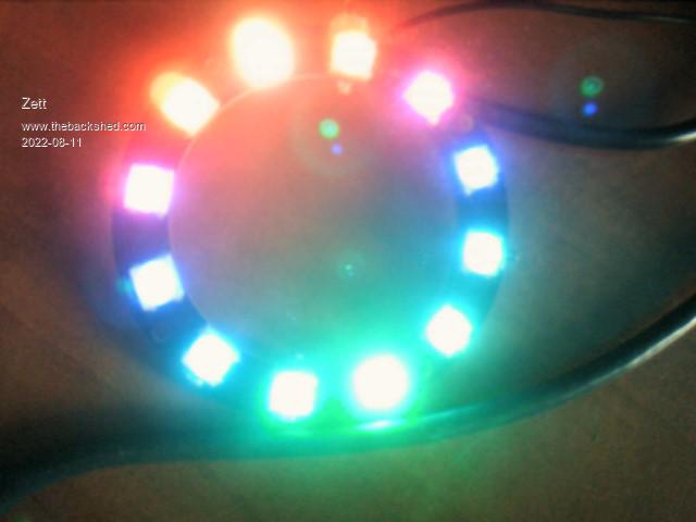

offcourse. thx dude! i now got 12 leds i can adjust the color of. from a touch schreen written in basic! this is a happy day!
now i gona make a led clock with these ws2812!

The code:
SetPin gp4,dout
lednr=0
Backlight 100
CLS
groen=&h000000
rood=&H000000
For e=0 To 239
Line 10,e,70,e,1,e
rood=rood+&h010000
Next e
uitlezen:
x=Touch(x)
y=Touch(y)
If y<15 Then y=0
If x>220 And x<319 Then GoTo volgende
uit:
b%(lednr)=ledkleur
Pause 100
Loop
volgende:
lednr=lednr+1
If lednr>11 Then lednr=0
ledkleur=b%(lednr)
ledblauw=0:ledgroen=0:ledrood=0
GoTo uit

now on to the time to var program. :)
got sec$=mid$(time$,7,2) and now make it in to 5 sec steps as a var%
Zett
Joined: 18/06/2022
Posts: 14
Posted: 07:11pm 09 Aug 2022
' clock
SetPin gp4,dout
CLS
sec=0
min=1
uur=9
wacht:
If Timer<5000 Then GoTo wacht
Timer =0
For e=0 To 11
 b%(e)=&H0
Next e
 sec=sec+1
  If sec>11 Then sec=0:minc=minc+1
  If minc=5 Then min=min+1
   If min>11 Then min=0:uur=uur+1
     If uur>11 Then uur=0
B%(sec)=&H010000
b%(min)=b%(min)+&H000100
b%(uur)=b%(uur)+&H000001
Loop
Clock on yt

Updated version.
now it got a next led button and it flashes the led that is selected.
and a CLR button. so you can set it to black again fast.
' ws2812 led circle 12

still got the idea to a save option and all leds same color

other update with buttons:
-next
-cls
-all
-prev
-rnd

More for in a lamp.
Youtube vid
