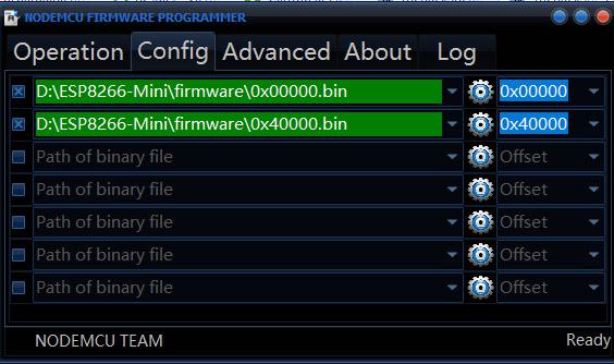

Firstly where can I get the .BIN files for this (or later versions) and, secondly, what is needed for the flash.
I have played around with NODEMCU Programmer and seem to be able to load various firmwares into the ESP8266-Mini but none of them work as the old one did with responding to AT commands etc.
I now cant get it back to a `working' i.e. responding to AT commands.
Can someone please point me to the required .BIN files and which order and addresses that I need to put them into the NODEMCU PROGRAMMER config screens as shown below..?
I have flashed (presumably successfully) many firmwares into the device and can see text in TeraTerm when I press the Reset button but none of the firmwares do what I want..
Reiterating again,
I would like links to a later version of the `standard AT command' firmware that I currently have
PLUS
which files I need to put into the config screen for NODEMCU and the starting addresses.

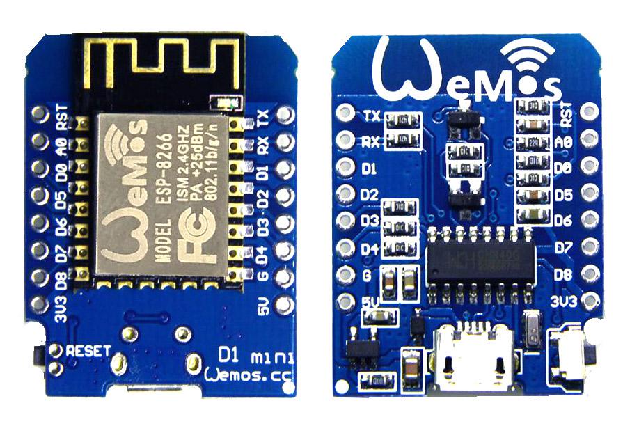

I think that is all correct, I am working with AndrewG on a project and he said he needed the last 2 commands to do what he needs in a program for some hardware we are working on but they were not supported in the `stock flash' version
For those who are following this thread with interest (or laughter as the case may be) the following is the procedure 'I' used to flash the chip. Mind you mine is only a 4Mb chip so I am not 100% certain all is working until AndrewG gets to test it.
I use an FTDI (3v3 version) USB-Serial-TTL cable and connect the D1-mini as follows:
FTDI    D1 Mini
5V   -    5V
Gnd  -    G
Rx   -    Tx
Tx   -    Rx
Then
Gnd   -   D3 (aka GPO0)

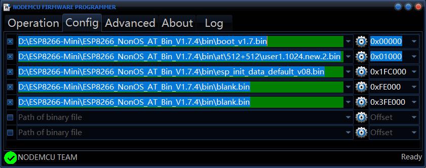

I then set up NODEMCU FIRMWARE PROGRAMMER  to point to the files in Jim's ZIP and set the memory locations for each as per the ReadMe file in the ZIP (settings shown to the right of the files in the following Screen shot)
Then I power my FTDI cable
Then in the Programmer,
Select the Com port to use (COM13 in my case)
Select Operation,
Select Flash
Very quickly you should see the AP MAC and SAT MAC as well as a QR code appear.
The progress bar starts incrementing and after roughly 1-2minutes it finishes with a GREEN tick.
Remove the GND from D3 on the D1-Mini and using Tera Term set for 115200 baud press the D1-mini reset switch.
If all worked you should see a bunch of gibberish followed by `ready'.
It is now ready for commands.
Thank you all for the assistance in this regard and I hope the above helps you update as well.

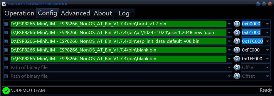

In any case after much trial and error by AndrewG and myself, Andrew came up with the following options (one of many listed in the files Jim sent but was supposedly for 16MB modules) and it seems to work fine EVERY time.
Using those files addressed above from the files Jim Uploaded I can confirm that the flash process I described with the files and addresses  shown in the above image works EVERY time.
Here is Jim's File file upload again.
ESP8266_NonOS_AT_Bin_V1.7.4.zip
Andrew and I hope that this will be of some help to others using the ESP8266-Mini (aka NodeMCU D1-Mini)
