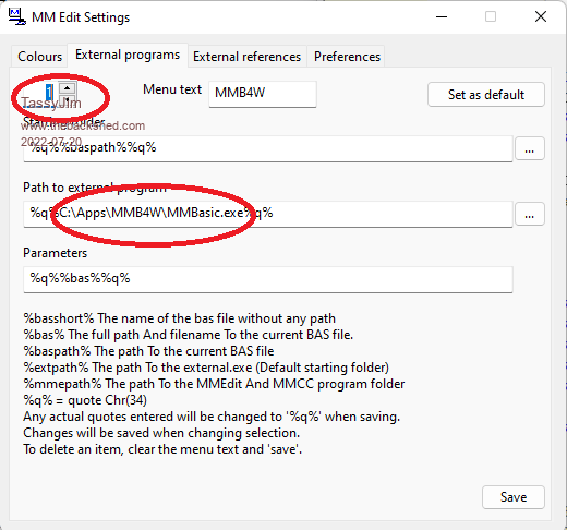

Assuming MMEdit V5,
Menu Action/Edit list...
Copy my settings but change the path to your copy of MMB4W.
Remember to SAVE
If you want to default to MMB4W instead of the original MMBasic.exe,
hold the shift key while selecting from the menu.
After that, the "run in DOS" button will be changed to your selection.
The first time you run it, there may be a delay while Windows AV has a think. After that it is instant.

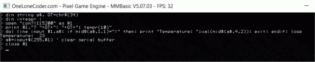

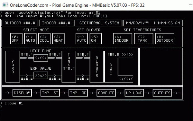

Peter--it depends on which version of my code you are trying to get onto the Picomite.
In the latest version (which is good for I/O control but might not be best for more complicated programs), I have nothing but MMBasic flashed to the PicoMite, the PicoMite is plugged into the PC using the USB port, and the MMB4W (or MMBasic DOS) program acts like a human interacting with the PicoMite through a terminal (e.g., TeraTerm) at the ">" prompt.
This means that anything you can do as a TeraTerm user, your MMBasic program can do by writing to and reading from the serial port which you get when you plug in the USB cable from the PicoMite.
(And by the way, are you talking about MMBasic for DOS or MMBasic for Windows? It makes a difference. You say Win7--I thought PeterM said MMB4W was for Win10 or greater, but I may be misremembering.)
In any case, with this configuration, you can test what you want to do using Teraterm. For instance, you could hook up a 3V3 LED with R to pin 1 and type:
setpin 1,dout: do: pin(1)=1-pin(1): pause 500: loop
This would cause the LED to blink. Now to get the same code to work from MMBasic on Windows, you need first to end Teraterm or switch it to another serial port so that it releases the port. Then in your windows program, you do something like this:
open "com7:115200" as #1 ' depending on which port Windows has assigned
print #1,"setpin 1,dout: do: pin(1)=1-pin(1): pause 500: loop"
If you need to get back a result from the PicoMite, like the result of reading a pin or a DS18B20, it's a little more complicated, but if you get this far, I'll be happy to walk through how I've done that.
(Oops, I see now you're saying "MMBASICW"--but the same can be done with MMBasicDOS, but without the pretty graphics.)

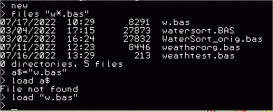

When I LOAD XXXXX$ or variations of it
I get "can't open file".
What ever is the problem it is going to be silly. I'm very good at that.

Posts: 4379
Posted: 11:40am 20 Jul 2022
  PeterB said  When I LOAD XXXXX$ or variations of it
What do you get from:
RUN "foo.bas"
or whatever the file is called ?
And which version of MMB4W are you running ? early versions probably copied the CMM2 and didn't have a LOAD command ... somewhat (pleasantly) suprised the current one (5.07.03b10) does.
Edited 2022-07-20 21:42 by thwill
