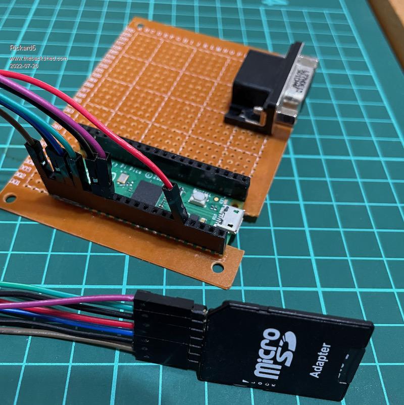

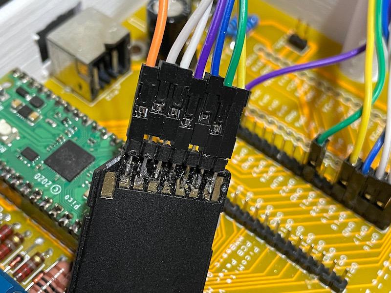

Somewhere I found enough information on hacking an SD Card directly to a Pico and did it successfully with :
OPTION SDCARD GP22
Unfortunately I had a situation and the card came disconnected from the pico and I cannot find that info again, does anyone know where I can find a hookup diagram

Hi thar perdner,
I've got no idea of the connections but, given the clarity of your photo, can you track the connections down by following the coloured jumpers?

You can put an SD card on any pins. It doesn't matter. You just set up OPTION SDCARD with the pin numbers that you used.
For a standars SD card:
Looking at the copper on the SD card holder, working from the bevel, the pads are
9 1 2 3 4 5 6 7 8
9 - no connection
1 - CS
2 - SDI (MOSI)
3 - GND
4 - 3V3
5 - Clock
6 - GND
7 - SDO (MOSI)
8 - no connection
By the way, if you are going to use a PicoMite VGA the SYSTEM SPI option isn't supported. You have to set up a SD card using OPTION SDCARD CSpin, CLKpin, MOSIpin, MISOpin

Rickard5
Joined: 31/03/2022
Posts: 463
Posted: 12:31am 20 Jul 2022
Unfortunately I used 2 Black wires And I can't track them down though the mess

Rickard5
Joined: 31/03/2022
Posts: 463
Posted: 03:42am 20 Jul 2022
OK SO I'VE WIRED WORKING FROM THE BEVEL
         - no connection
gp16 - CS
Gp17 - SDI (MOSI)
Gnd - GND
3v3 - 3V3
Gp18 - Clock
GND - GND
GP19- SDO (MOSI)
         - no connection
But the real question is which is the mosi and which is the MISO ?
and I reflashed my Pico with picomitevga5.07.04rc3.uf2 and when I do "option SDCARD GP16, GP18, GP19, Gp17
I get "Error : Pin 21 is in use" returned

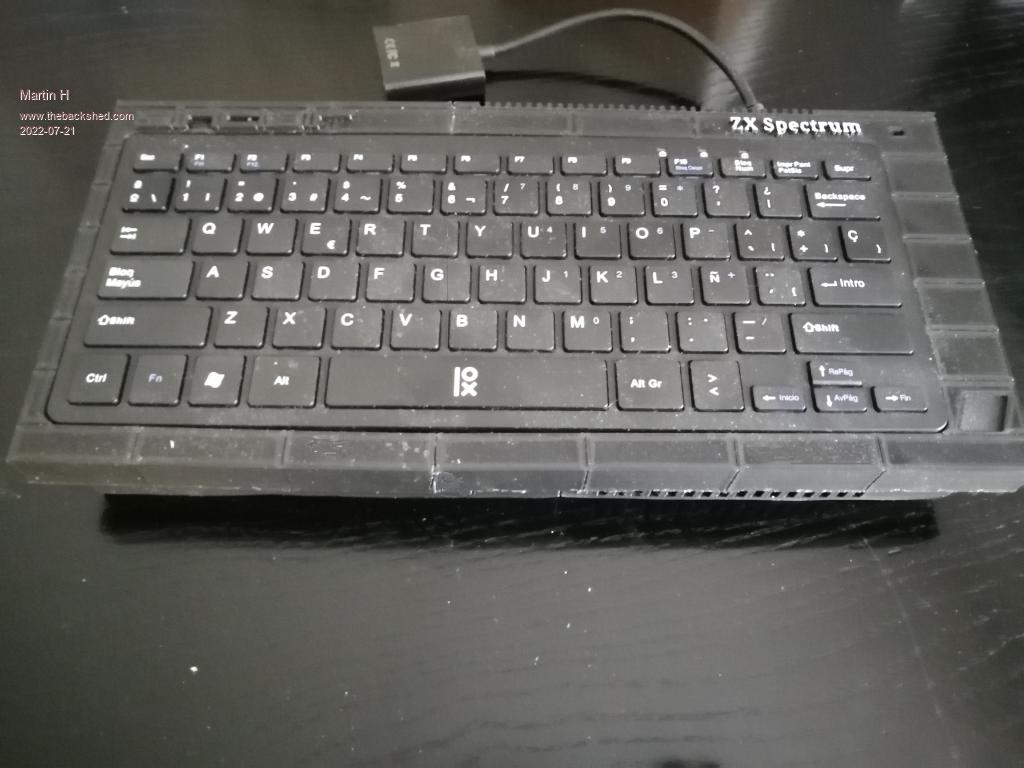

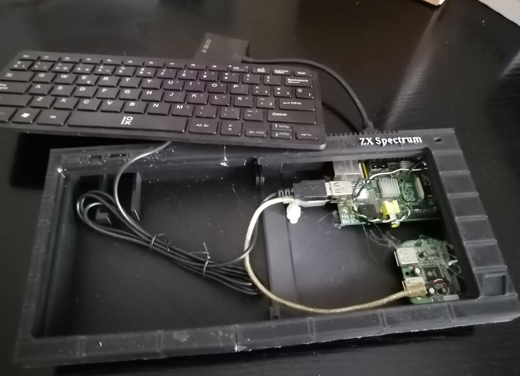

Martin H.
Joined: 04/06/2022
Posts: 1573
Posted: 09:31am 20 Jul 2022
Works fine in my "Prototype"
ugly but a New Case (for the counterfeit PicoGame Board)is in Progress
'no comment

Martin H.
Joined: 04/06/2022
Posts: 1573
Posted: 11:19am 20 Jul 2022
not Ali Express ...
I build the circuit, according to the plans, on perforated grid board
and this should fit in the printed Case
so the feather in your cap has to wait ;-)
Edited 2022-07-20 21:21 by Martin H.

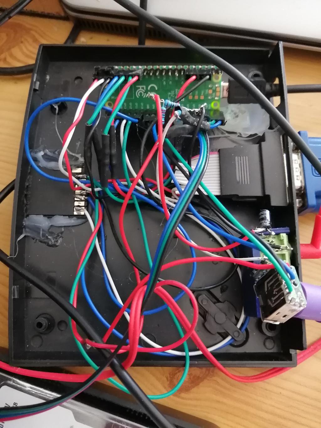

pwillard
Joined: 07/06/2022
Posts: 347
Posted: 01:40pm 20 Jul 2022
There is a case?  Where?

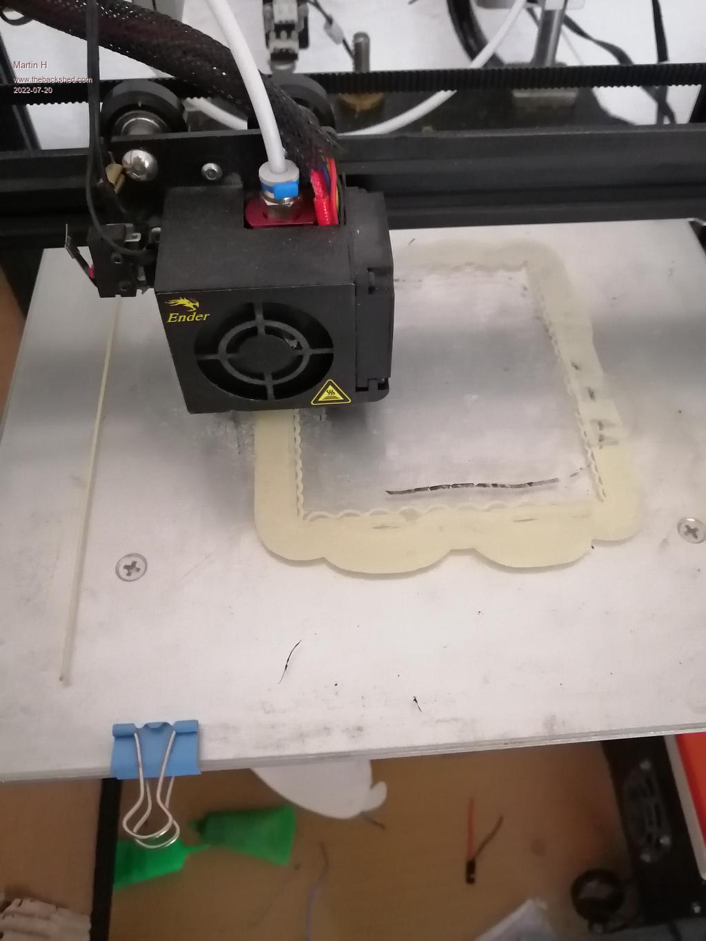

Martin H.
Joined: 04/06/2022
Posts: 1573
Posted: 02:02pm 20 Jul 2022
  pwillard said  There is a case?  Where?
it will be a modded Version of this one:
https://www.thingiverse.com/thing:1496674/files
(still printing)
'no comment
