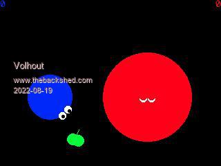

Posts: 6194
Posted: 06:32pm 18 Aug 2022
An update for the Circle game: Circle2.
The game still requires 2 NES controllers connected to the VGApicoGAME board.
The game is fast paced game for 2 players. Target is to eat apples and grow in size.
Tactics can keep opponent away from food. The player who moves when colliding into the other looses weight...
Win counter in top corners.
All graphics are circle commands (hence the name....)
Please enjoy....
