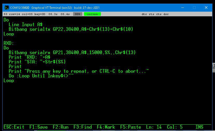

EDIT: The serialtx one seems to work perfectly.
Have tested a few baudrates up to 115k2, all of which are working fine.  Not sure if there is an upper limit to the baudrate?
I will have a play with the serialrx one now, and will post back with results.
EDIT: Serialrx also works beautifully.
Any chance this can be added to the standard firmware and also the VGA version Peter?
Edited 2022-07-05 15:04 by Grogster
