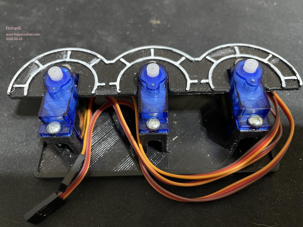

This is Kinda nuts but I really can't find a sample answer in the documentation, and I'm Lazy but ........
can I do Graphics on the Picomite though Terra Term ?
I built this servo fixture to be a physical servo based read out for a project I'm working on, but I'd also like to have a Graphical representation of the gauge cluster on screen as well
if I read correct and I use BLIT since there is no sprites, I have to create a separate Bitmap for every needle position?
Edited 2022-04-22 15:25 by Rickard5

TeraTerm is text based, not graphics but you can always use ASCIIart to produce interesting scenes.
Search the forum for GFXterm. It has some graphics ability.
To draw moving pointers, I usually use the line command. You have to erase the old position by over-drawing in the background colour then draw the new position.
To make life easy, draw your instrument panel with a mono-colour area for the needle to move in.

As Jim says, you can only send text over Tera Term. However, Tera Term will work with the VT100 escape code system so you can do some interesting things.
https://www.thebackshed.com/forum/ViewTopic.php?TID=13729&PID=167644#167644#167644

you can find GFXterm here:
http://www.thebackshed.com/docregister/ViewDoc.asp?DocID=22
in theory, TeraTerm can do graphics using its builtin TEK 4010/4014 Vector Graphics emulation that (i think) draws in a separate window. but i have never managed to make much sense out of it all. for example C code, see:
https://sparklogic.ru/code-snipplets/tek-4010-4014-vector-graphics-terminal-demo.html

For a pointer that can point in any direction you can also use the TRIANGLE command. For a rectangular pointer use two narrow right angle triangles with a shared hypotenuse.
