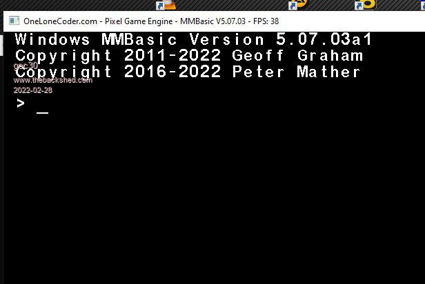

Posted: 03:55pm 27 Feb 2022
Hi Pete

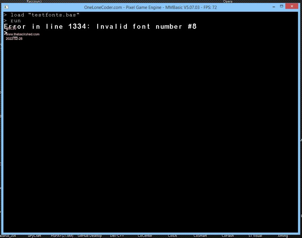

with beta, mode -16 is ok. But I have in "mode 16" the same problem: after init screen, cursor is out of window. In fact position 0,0 is in screen border, not in visible screen, you don't add heigt of top screen border
pb with win10 is probably pb of audio driver. In this pc, I use fiber output to audio external box

  Quote  But I have in "mode 16" the same problem: after init screen, cursor is out of window. In fact position 0,0 is in screen border,
I assume you are running on a 1080p monitor. Mode 16 works perfectly on a 4K monitor. You can't get 1920x1080 on a 1080p monitor unless in fullscreen. I've made the border the minimum possible allowed in windows.
is it possible to load more than 5 fonts. As others MM, 16 fonts are the best
The font handling should be the same as other MM - looks like a bug
I use 2 screens in 1920x1080 each. Problem is not here, problem is just that in "mode 16" I have no cursor it is no visible because it is out of border window
Here my test fonts program

The font issue was a bug - your test now works perfectly on my development version - will post tomorrow.

  matherp said  The font issue was a bug - your test now works perfectly on my development version - will post tomorrow.
bug is in this part
for i=1 to nbfonts  'if nbfonts > 7 then it bug
 font i,1
 vsize(i,1)=MM.info(fontwidth)  'dim vsize(16,3) as integer
 vsize(i,2)=MM.info(fontheight)
next i

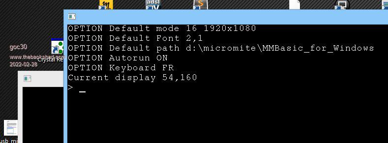

Posted: 11:53pm 27 Feb 2022
  matherp said
The cursor issue is something to do with your set-up. I can't replicate on either a 4K monitor or a single 1080p monitor. Do you have an issue if you use mode 15?
I understood the problem, in fact with win10, I have window edges reduced to the strict minimum, while with win8 I have window edges of standard size
win10
win8

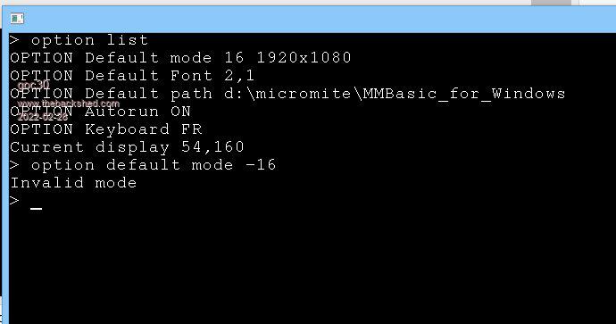

but I have always pb with "option default mode -16" who return same error

  Quote  but I have always pb with "option default mode -16" who return same error
This is correct. I made the decision not to allow full screen modes to be set as default. Full screen on Windows can be a problem (no access to menu bar etc.) so I thought it better to only allow it to be set once in the application. This is open to discussion but that was my thinking

Posted: 05:09pm 28 Feb 2022
of course, but the problem is that this mode does not stay, and sometimes it starts to flash. Finally at each cls or at the exit of edition, the cursor disappears. We don't even know where we are anymore. Is the cursor just hidden or is MMBasic crashing. Even at startup, the version of MMBasic is not visible. it is unmanageable!!.
There is a basic principle on Windows. The cursor at position 0,0 should be at the top of the visible part of a window, not behind the top border. And this, whatever the resolution. And if there is a menu, position 0,0 is at the bottom of the menu bar.
it is Windows that manages this automatically, so any operation different from these principles must be considered as a malfunction

How about I get rid of full screen mode completely but create a new mode for 1080p screens which is the maximum size that will fit above the task bar completely within the screen. Something like 1850x980? I can play with the setting to get the optimum
