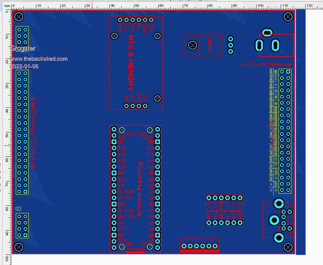

This follows on from the other thread, but I thought it would be better not to hijack that thread, and start a new one for this PCB.
This is what I have so far - just doing the major component placement at this stage:
PM down the bottom of the board to give easy access to its USB socket.
ER connector at left side, standard 4-7" TFT connector at right(both on bottom)
3940 1A LDO 3v3 regulator to power both types of screen.(won't use the PM 3v3 output)
Four-channel 5v/3v3 bi-directional level corrector(two channels for keyboard, the other two for COM1)
Standard RTC module.
Six-way PCB header for the six pins left over after all the tracks are laid.
I plan to squeeze this layout a bit more horizontally, to make it 100x100.
Once complete, I will certainly release all gerbers and drill data files etc.

Just a thought...
I don't know if both versions of the display have the same fixings, but would it make sense to make this a split board, each piece lining up on the display fixing holes but making up 100mm square before cutting? The two could be linked just by wires as there's not a lot of connections if you can put both display connectors on the same end as the PicoMite. It may not be possible if the display pins are too dissimilar in layout, but it's just an idea.
panky

FWIW, I feel a SSD1963 5" or 7" form factor for the backpack pcb would make sense (eg. Explore 100 or MZ 144). There already exists an SSD1963 to East Rising 8/9 inch LCD adaptor so for the limited number of such users, spending PCB real estate for this LCD seems wastefully unless it can be used for something else.
Given the existing support for SPI displays, would you consider connectors for an ILI9341, with an i/o connector to re-use the 8 parallel data lines released by not using the SSD1963?
Also, perhaps an on-PCB SD card?
Also as this will significantly expand the usage options, I feel an analogue expander may be worth considering?
Just some idle thoughts!

2 suggestions:
1/ add an 8 pin header for the 6 free IO pins on the pico + GND + 3V3
2/ provide a footprint for a (micro) SD card.
It is nice that the parallel display can be supported, but only 6 pins free limits the application to a terminal. Maybe that was the idea from the start ?
But if you take away 4 of the 6 IO pins by adding the RTC and audio, you are basically removing all functionality outside the terminal function. Just 2 pins remain for COM. No IO possible anymore.
This is a nice -proof of concept- but is there demand for a serial terminal with embedded MMBasic ?

How about a RTC module and a 28-pin Micromite on the GP21/GP22 I2C bus?
That way there are 17 programmable IO pins to play with and a RTC all for the sake of 2 pins - and the code for the Micromite is already in a workable form in the Micromite "Get Started" manual.
Or, GP17/GP20/GP21 as a RS485 interface to as many hundred devices you feel like hanging off it.
Or put a ESP8266-01S on it and wi-fi link to a load of remote stations.
Six IO pins is quite a lot when you come to think of it. :)

  Mixtel90 said  How about a RTC module and a 28-pin Micromite on the GP21/GP22 I2C bus?
Good idea's !!!
Put these on Grogsters board, and we could have a winner...
Current design for this board forces you to design another board for the IO (if that is what you need for your project). Or maybe the serial terminal is just what you need ?

  panky said  FWIW, I feel a SSD1963 5" or 7" form factor for the backpack pcb would make sense (eg. Explore 100 or MZ 144). There already exists an SSD1963 to East Rising 8/9 inch LCD adaptor so for the limited number of such users, spending PCB real estate for this LCD seems wastefully unless it can be used for something else.
You have a point.
The ER socket is there, as that was one of the things peter suggested the PCB have, so that is where that came from.  See the other thread.
Question: Other then me and WhiteWizard and perhaps matherp, does anyone else use the large 8" or 9" ER LCD very much?  It may well be a better idea to design for the standard 40-pin connector, and leave off the ER connector and just use the adaptor PCB as you say.  That is a very valid point.  It depends on how many people use the ER displays.  I have ONE, but I only have it for testing.  I don't use the ER displays by default, as the standard 40-pin connector is more common.
Mixtel90's idea of hanging a 170 Micromite off the I2C bus is a clever one to get more I/O pins, but I distinctly remember there being a dedicated I2C I/O expander chip already.  Would that be a better choice?  I forget the part number, but I will have a bit of a search.  It was also a DIL of around 28 pins, but then you would not need to program a 170 to do the same thing that an I/O expander chip could do natively, and you simply command it via the PicoMite MMBASIC.
...or simply have that as an add-on board, which would suit EVERYTHING - CMM1, CMM2, CMM2_G2, Micromite, Arduino, PicoMite, Pi Zero - ANYTHING with a spare I2C port....
I think I like that idea more then including on on THIS board, cos a separate add-on I/O expander board would be completely universal and could be used on just about anything.  What about that idea as a 2nd PCB?
EDIT: Come to think of it, eBay and AE etc probably already have traders selling such I2C expander boards.  I'll do a quick search for "I/O expander for Arduino" - that kind of wording usually produces results.  No point in re-inventing the wheel...

My reason for suggesting using a Micromite as an I2C expander is because it's programmable. You can do anything with the pins that the Micromite will allow, so you can have PWM, analogue in, digital, oc outputs and counting all on the same chip at the same time. If you are willing to sacrifice one of the 17 IO lines and a host pin you can use it to feed back to the controller as an interrupt. In that way the Micromite can run semi-autonamously, triggering the host on, say, analogue input out of range. It's a lot more flexible than the I2C expander chips. Ten analogue inputs and four counters anyone?
The software to implement the Micromite as an expander is already written (by Geoff so it's beautifully explained!) for both that and its host. There are SSETPIN and SPIN commands and a SPIN() function all ready to go. :)  The only thing that might be worth looking at is that as things are the address is fixed in the software for a Micromite. I wouldn't want to sacrifice pins to be able to change it so some way to do that in software might be nice.
It's also infuriatingly easy to work with:  ;)
send: mode, pin, value
(if it's a read command then value is a dummy. Then send extra read command and value on that pin is returned as a 12 character string)
I started a design to put one of these in one of the 90x70x28 boxes, with an I2C + IRQ loopthrough connector for further expansion. It's partway there but I think I can do better now. :) Power would be at 5V, but with I2C at 3V3. That's to allow each box to have its own 3V3 regulator for its output load without sinking the 3V3 output on a PicoMite. It would also have easily disconnectable pullups and internal connectors for ICSP and console.

  Quote  My reason for suggesting using a Micromite as an I2C expander is because it's programmable.
Why not keep it in house and use another PicoMite - I2C slave supported same as MM2, more pins, more memory, much faster

I used the Micromite because it fitted in the box. :)  It also has a lot of analogue ports, something that the PicoMite is short of.
There's no reason why a PicoMite shouldn't be used, or a 40-pin Micromite or whatever. Evan a spare CMM2. :)
I'm having my own play with a 5" SSD1963 board too - and the Micromite is about the same length as the RTC module. They pack in together very nicely. It's all a game. :)
I've found some nice microSD modules on ebay. At first glance they have the dreaded resistors on them, but when you look closer they have a bypassed electrolytic on the supply and 10k pullups on the pins. No series resistors. Only a single GND pin and no CD pin, so there's only 6. I'm changing the PicoMite VGA mini to use one of those instead of the 90 degree one as they are much more common (and even smaller).

This might be a stupid question
But
Could you use a 2nd Pico with the 2nd just "mainly" being for the 16bit display?
Probably wouldn't work but just a thought as that way you'd have all the pins on the 1st one as well as it doing all the main work

You could, but at best the display one would be linked over SPI so your lovely parallel interface display would be slowed down. :)

  Mixtel90 said  My reason for suggesting using a Micromite as an I2C expander is because it's programmable. You can do anything with the pins that the Micromite will allow, so you can have PWM, analogue in, digital, oc outputs and counting all on the same chip at the same time.
Another excellent idea, and I see why you were going down that path now.  I was not thinking outside of basic I/O.
2nd PicoMite sounds like a plan, as they are so cheap and AVAILABLE. (for now, anyway)
170 MM2 chips are still very hard to find.
I think there are some DIL's to be had at Microchip, but all the other footprints are now stating February 2023 - so it hasn't got any better!!!!
