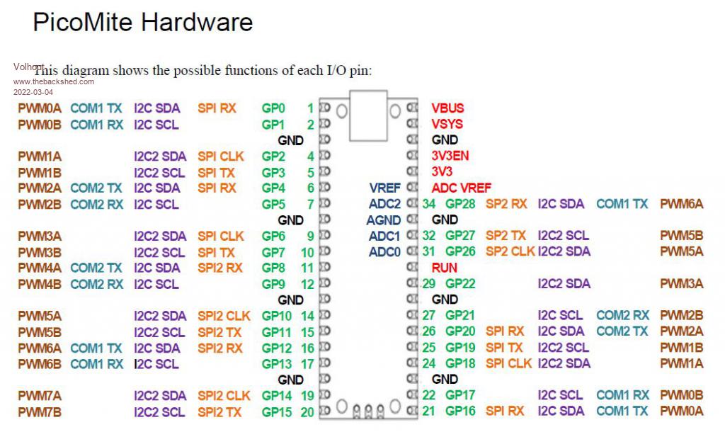

using the BACKLIGHT command
Posts: 6198
Posted: 03:42pm 03 Mar 2022
Hi Bill,
Backlight as an additional paramter in the OPTION LCDPANEL... Never too old to learn..... Thanks. I didn't know that. Must have missed it in Geoff's user manual.
According to the PicoMite user manual, GP22 is PWM3A. I think you looked at PIN22. PIN22 is not GP22.
I think T_out must be connected to GP16 (SPI_RX or also called MISO pin) to be able to read the coordinates from the Touch controller chip over the system SPI bus.
Edited 2022-03-04 01:45 by Volhout
Posts: 9246
Posted: 04:01pm 03 Mar 2022
OPTION SYSTEM SPI GP18, GP19, GP16 'clk, mosi, miso
OPTION LCDPANEL ILI9341, L, GP21, GP20, GP17, GP22 'or, dc, rst, cs, bl
OPTION TOUCH GP15, GP14 'cs, irq
I think the above should work fine, lew. GP22 is PWM3A so I don't think PWM3B can be used for PWM. You do need T_OUT if you are going to use touch.
