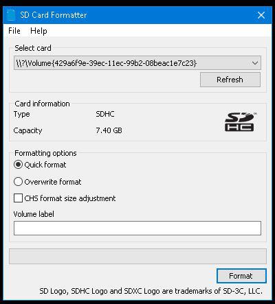

Interestingly, SD CARD FORMATTER does see the card, but with an extremely weird path:
WTF?

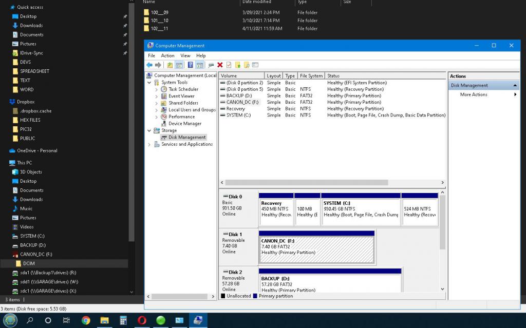

UPDATE: Have fixed this.  For reasons still unknown to me, Windoze had stopped assigning a drive-letter to the SD card - I still can't work out WHY that would be.
Open Device Manager, the card shows up there, less a drive-letter.
Right-click the SD card, assign a drive letter, and let Windoze choose a drive letter - F: in this case.
So, all working again, but this is weird.  I wonder why Windoze would just seemingly forget how it goes about assigning a drive letter to an SD card, and I have to assign it manually?
I have safely-removed the SD card and put it back in, and Windoze picks it up - now.
