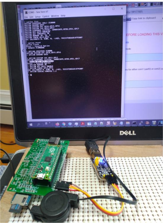

Implements the option of using a standard uart as the console
OPTION SERIAL CONSOLE uartapin, uartbpin
uartapin and uartbpin can be any valid pair of rx and tx pins for either com1 (uart0) or com2( uart1). The order you specify them is not important
Use
OPTION SERIAL CONSOLE DISABLE
to revert to normal the USB console
Edited 2021-11-03 01:42 by matherp
Posts: 3885
Posted: 04:34pm 02 Nov 2021
  matherp said  Implements the option of using a standard uart as the console
Well ok.
Though I'm not exactly sure where I would go next with this.
(Better put a note on this to remind me that it's on UART console; otherwise I'll be befuddled if I try to access it through USB.)
Posts: 9246
Posted: 04:40pm 02 Nov 2021
Well, the next stage is probably to connect it to Geoff's VT100 terminal. :)

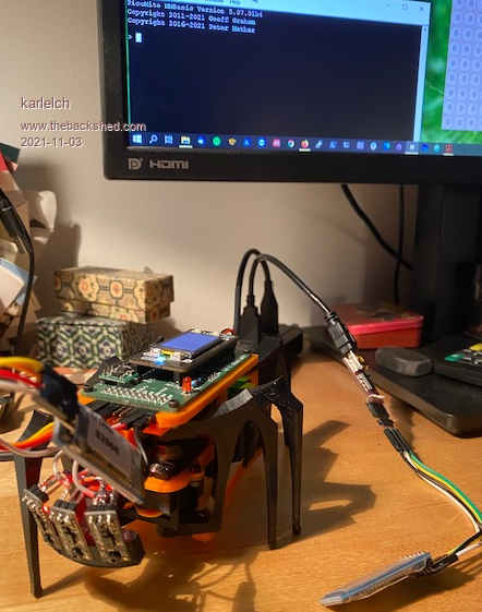

karlelch
Joined: 30/10/2014
Posts: 361
Posted: 05:42pm 02 Nov 2021
Very cool!
Now I can program via a simple bluetooth link using two HC-05 modules :-)

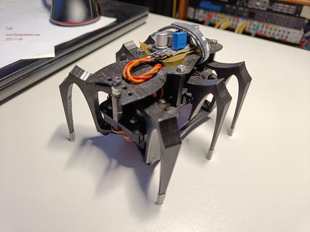

Calli
Joined: 20/10/2021
Posts: 74
Posted: 02:55pm 03 Nov 2021
  karlelch said  Very cool!
That sensor array is impressive!
Greets from the evil twin:
I have few time at my hands these days, but... SOME DAY...
atm there is a Tiny RP2040 in there, time to test PicoMite on it.
Carsten
