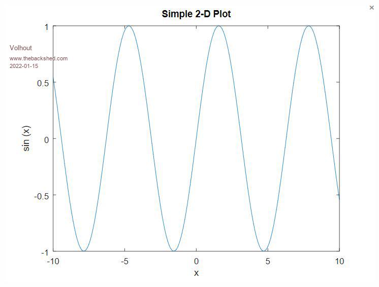

@Peter,
I am sure the CMM2 is as complete as anybody could wish.
But I do have a request for additional functionality.
Could we add a simple 2D plot command ?
Below example from Octave is not MMBasic, but is explanatory of what I am envisioning.
x = -10:0.1:10; # Create an evenly-spaced vector from -10..10
y = sin (x);    # y is also a vector
plot (x, y);
title ("Simple 2-D Plot");
xlabel ("x");
ylabel ("sin (x)");
It is the simplicity of the "plot" command that helps people analyze data.
This is as simple as the output would look like, nothing fancy.
I know this can be done in MMBasic. Every project I re-invent the plot function, since I am very visually oriented.
Is this something that will still fit in the CMM2, and are you willing to code it up ?
Thank you in advance,
Edited 2022-01-15 00:07 by Volhout
Posts: 4379
Posted: 02:25pm 14 Jan 2022
It's not my baby, but why would we need graph plotting in the firmware? Is this not the perfect use for a .INC file, I'm sure our prolific @William Leue or any number of others could knock one off for this purpose. Possibly if you wanted 3D contour plotting you would need firmware level of performance, but that's what CSUBs are for.
Edited 2022-01-15 00:26 by thwill
Posts: 5995
Posted: 03:10pm 14 Jan 2022
@thwill
You are right. All the graphics functions are there, so it is definitely possible in MMBasic, and not CPU intense. I simply did not create an ".inc" yet, I'll do that my next project, so I can benefit for the next...
I was stunned by the simplicity of the implementation in Octave. Hence the request.
I will withdraw my request.
Edited 2022-01-15 01:11 by Volhout
