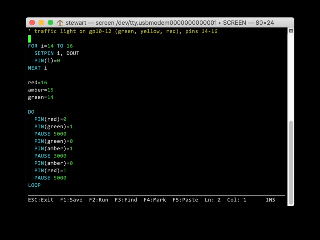

Geoff,
am i Right, that you ask for a terminalemulator for Linux/MacOS?
If this is the case, you can use SCREEN:
screen /dev/<console_port> 115200

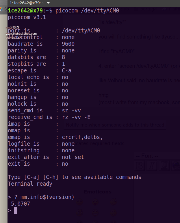

For a terminal program, minicom works. Install it (+ xmodem support) on Debian-based systems (incl Raspberry Pi OS and Ubuntu) using:
sudo apt install minicom lrzsz
then run it with
minicom --device /dev/ttyACM0 --color=on
This should connect directly with mmbasic's REPL.Make sure you use the right device name.

Mac OS
I've just had the chance to run a Pico with mmbasic installed on a Mac.
- the port will be of the form /dev/tty.usbmodem*, as in /dev/tty.usbmodem0000000000001
- no driver is required
- Mac OS Terminal is already a full VTxxx emulator, and Mac OS comes with screen installed. You can run it like this:
screen /dev/tty.usbmodem0000000000001
(no serial rate required)
It seems to support the editor:

In debian you can use picocom too to connect your pico to PC
sudo apt install picocom
I believe in raspberry pixel repository you can found this program, in amd64 Debian have it.
Best regards,
