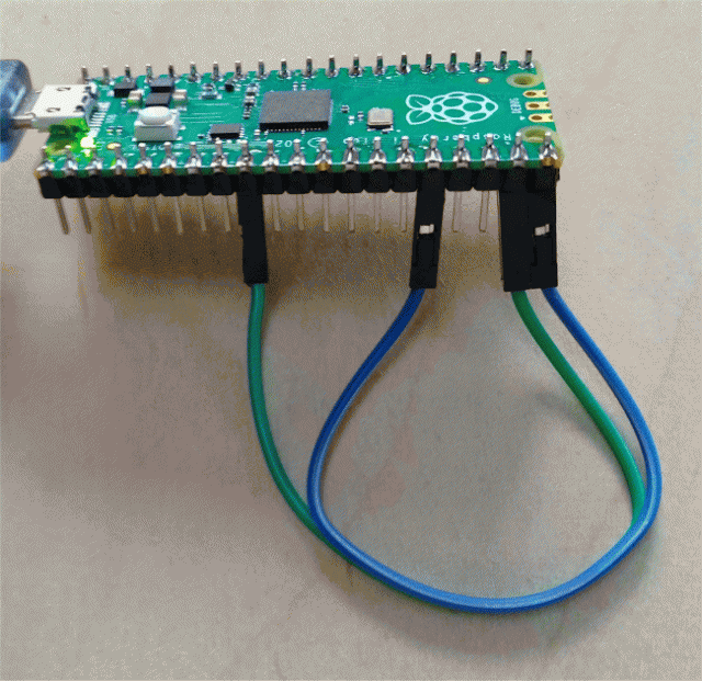

  Quote  This is to test an SPI port on a PCB.
Connect SPI-TX to SPI-RX (out/MOSI or whatever you want to call them), Connect SPI-CLK to a count input.
Type ?SPI(123),PIN(countpin)
If you get 123, 8 back then its working

  matherp said  Type ?SPI(123),PIN(countpin)
I get 123,1. What have I done wrong?

  Quote  I get 123,1. What have I done wrong?
Should work - try the clock at 10000 and put a pause 1000 before reading the count pin
Posts: 3885
Posted: 02:12pm 25 Jul 2021
  matherp said  Should work - try the clock at 10000 and put a pause 1000 before reading the count pin
Thanks. After:
option count 9,10,11,12
setpin 19,spi1sck ' SPI1 SCK
setpin 20,spi1tx  ' SPI1 MOSI
setpin 16,spi1rx  ' SPI1 MISO
spi1 open 10000,0
setpin 9,cin
?SPI1(123);" ";: pause 1000: ?PIN(9)
Gives "123 8".

  Quote  Gives "123 8".
That test meets your original brief by proving SPI is working properly
Posts: 3885
Posted: 02:41pm 25 Jul 2021
  matherp said  That test meets your original brief by proving SPI is working properly
I'm happy with that test, thank you. It's a very concise exercise in showing functionality (and the first time I've actually explicitly used either SPI or COUNT).
