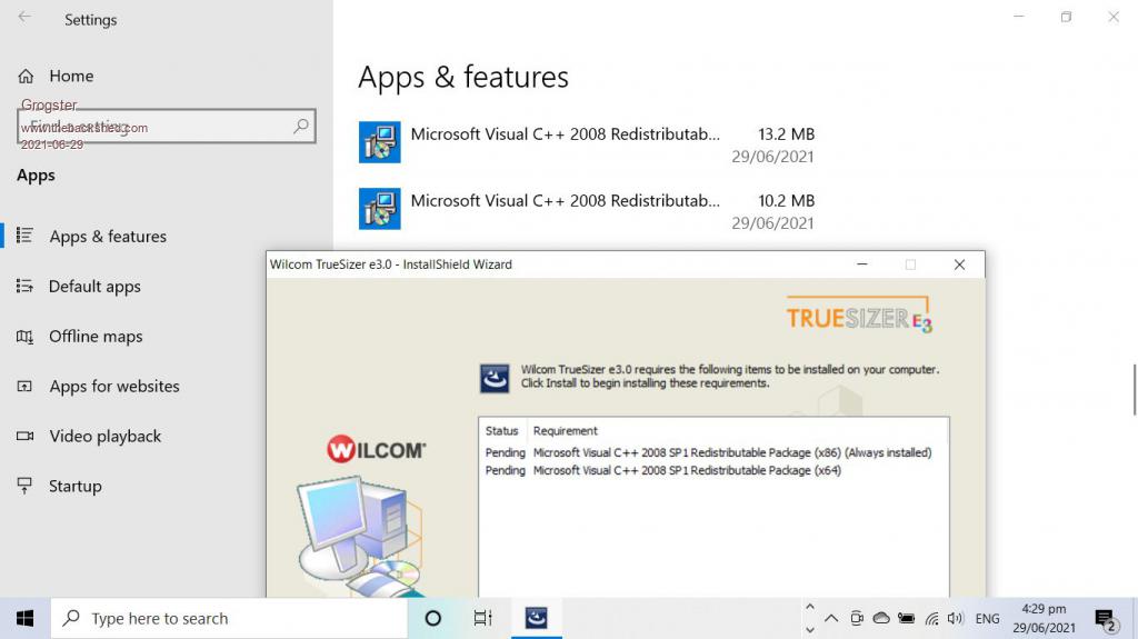

This one is interesting.  New laptop, trying to install Wilcom TrueSizer application, which is used to translate between Janome and Brother sewing and embroiding machines data files.
The installer keeps saying I need the C++ 2008 SP1 redistributable, but they are already installed.

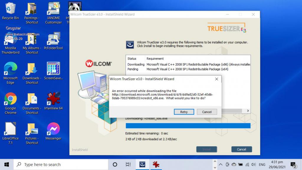

I suspect the installer is NOT checking that, it is just saying it is going to install them - which would be fine, but the links are no longer valid, and the installer DOES NOT give you any alternative - such as SKIP for example.
Does anyone know a way around this?
I suspect that Microsoft have moved the location of the download, so the embedded link in the installer is now no longer valid, so the installer can't download what it wants to, and falls over at that point.
Wilcom, who made the software, now only do a cloud-based tool, but we need the installed application one as it also allows File Explorer to show thumbnail images of the JEF files. (Janome Embroidery File)  Windows knows nothing about JEF files, and none of the standard picture viewers can even OPEN the files - they all say the files are corrupted, but they are not, as you can open them all fine in the Janome software package.
My friend REALLY needs that software, as it is how she converts between Janome and Brother file formats, and without it, she is pretty stuck.
The old laptop she had, which has exactly the same Windows version on it(ten home 64-bit) DOES run this software, so someone at some point, has worked out how to get around this issue, but I have not been able to discover the key to this problem yet.

Don't know whether you're still trying to resolve this but you may be able to work around the problem using a webserver and some DNS tweaking...
The basic approach is to force a redirect to the files no longer available from MS' public site to a local copy.  There are many ways that this can be done but approaches that come to mind include:
- for the webserver:
      + running a local webserver on the target machine listening on 127.0.0.1 (localhost)
      + running a webserver on a Linux box
- for the DNS:
      + if Win10 still has the "hosts" file capability add an entry for www.microsoft.com pointing at 127.0.0.1 (or whatever IP address your webserver is on)
      + you may be able to use your router's DNS capability to add a record for www.microsoft.com to point to the webserver (which could be 127.0.0.1)
      + a much heavier weight solution would be to run a proxy server like Squid on a Linux box with the Linux box's /etc/hosts file containing the www.microsoft.com record (would need the Win10 box configured to use a proxy for the web browser internet connection)
With a setup along these lines I'd be trying to run the installer on an isolated network to avoid complications with net access; if that's unavoidable the proxy server approach might be necessary.
All approaches will need both setup and cleanup work, but given the installer is old enough not to know about SSL connections (and care that certificates are valid!) it should be workable.  Good luck!

I would need to be able to host the required files for the installer, somewhere locally, but how do you tell the installer to look for the LOCAL copy and NOT try to download from the MS copy - which no longer exists?
That is hard-coded as a link in the installer, so how do you get around that?
