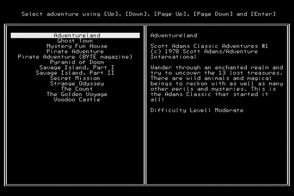

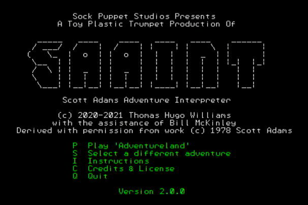

I am pleased to announce the release of SAAINT, the Scott Adams Adventure Interpreter for the Colour Maximite 2.
This is based upon the "Pirate Adventure" interpreter included on "The Welcome Tape" and its creation was instigated by Bill/@Turbo46 who did the early running with extending the interpreter. I then came in and did some rework, dragged my feet and then eventually added some bells, whistles and unnecessary lily gilding
With the kind permission of Scott Adams this release is distributed with the 12 original Scott Adams Classic Adventures. You can also find a dozen or so more adventures by following the links from the SAAINT git repository. Please note that Bill and I did not test all the adventures to completion (or even a significant fraction of them) and I would be eager to hear if you encounter any issues - though be warned, most of the spelling mistakes are Scott Adams originals.
Get it here: https://github.com/thwill1000/cmm2-saaint-public/archive/refs/tags/release-2.0.0.zip
Read more about it here: https://github.com/thwill1000/cmm2-saaint-public
