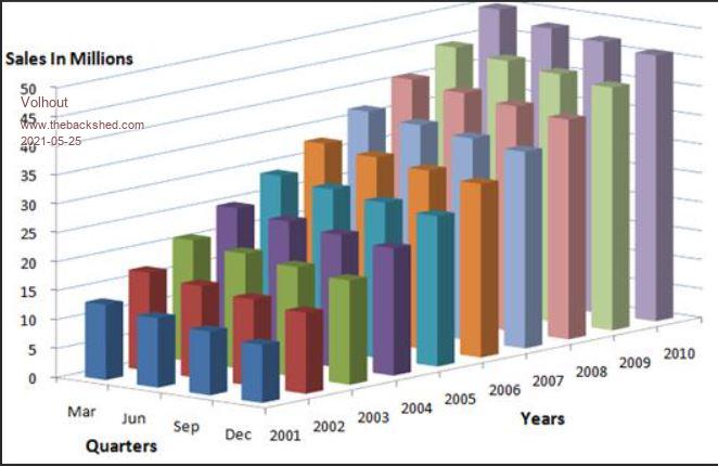

To me it is not entirely clear what you want to establish. In your excel sheet I see no Z axis, only linear conversions of X and Y.
If you need to represent 3 dimensional data in excel, excel has graph formats for it.
If you want to represent 3 dimensional data in MMBasic, you'll have to do some conversion like :
Xscreen = k1*Xdata + k2*Ydata + k3*Zdata
Yscreen = k4*Xdata + k5*Ydata + k6*Zdata
For fancier graphs like the Excel graphs, there is more calculation required.
