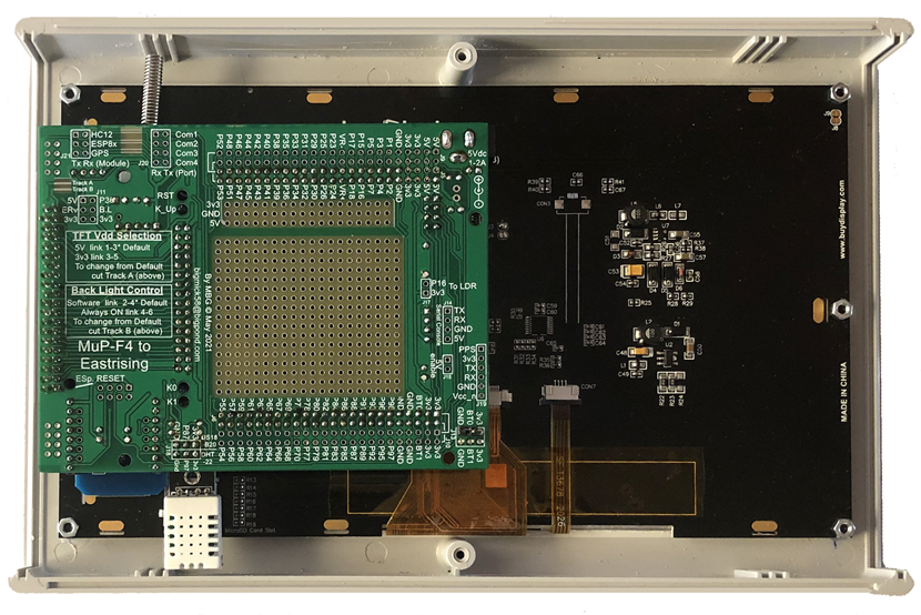

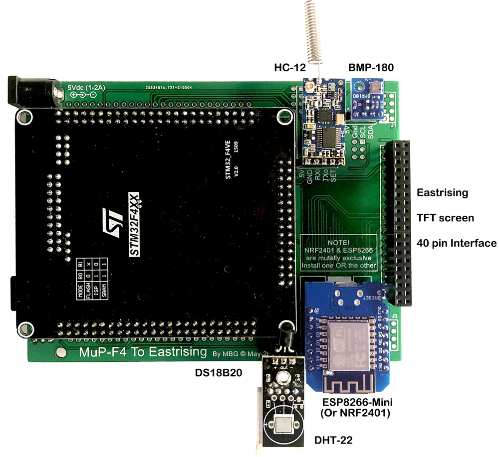

Top View

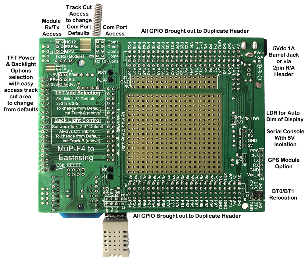

Bottom View
Attached to ER 9"

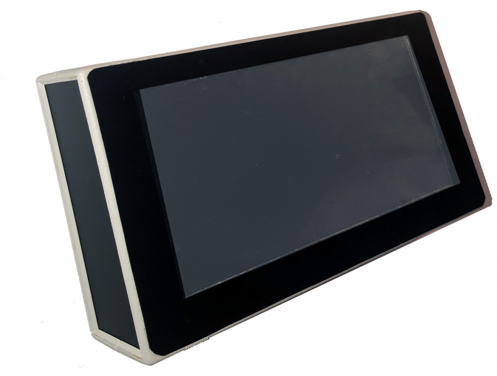

Case Closed

As is usual, there are a couple of minor issues with this first run.
The Main issue is 2 pads are erroneously connected to GND but I will drill these pads away and they will have no impact on the PCB. The rest is relatively minor.

We have just discovered that there is more than one pinout for the DHT22 and Andrew's and My modules have different layouts, I designed it to suit my layout..
Most people would want to mount the DHT22 away from the board anyway so it is only 3 wires and can be plugged up as required to suit your module.
Also I have the DHT pins in this board powered by 3v3 the next one will go to 5V as that is more in line with the specs, although many state that it works on 3v3.

Thank You, and no module plugs directly to the F4 board, all modules connect to the 'MuP-F4-EastRising' PCB.
There should be no need to access the F4, the USB port and SD card are still accessible (with the rear of the case removed) and the mini switches are all reachable through holes drilled in my F4-ER PCB. If you look carefully in my first image you will see holes drilled for the 4 switches and the ESP reset button.
Even the 20way R/A header is accisble without removing the F4.
In fact it isnt so easy to actually remove the F4 as there are 2 x 48pin GPIO plus 32pin TFT header Plus 8pin NRF pass through plus 4pin serial console, a total of 140 pins (male/female sets) attaching the F4 to the F4-ER board.
I will look at the thread you mention on battery backup (do you have a link??) to see what that is all about, but that may be a user's choice.
As to switches as mentioned they are accessible and I have replicated the BT0/BT1 links so you can flash the F4 without removing it.

The case is available from Element14 >>> Case <<< and quite cheaply and it looks great.
I cut the hole with my dremel and the fascia is actually a thin black plastic cover from a folder that you often get with clear sleeves to insert A4/Letter sheets into. Readilly available and dirt cheap. And looks reasonably good.
