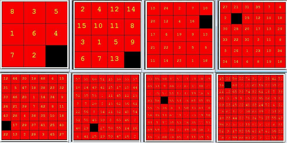

Here are samples of the 3x3 through 10x10 screens (it's all crisp on the actual display).

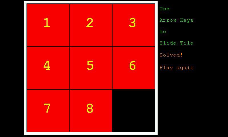

Here's a winning game:
I'll admit that it did not even attempt to play beyond the 3x3 level, but I don't think I did anything which would cause the program not to work as on the CMM2.

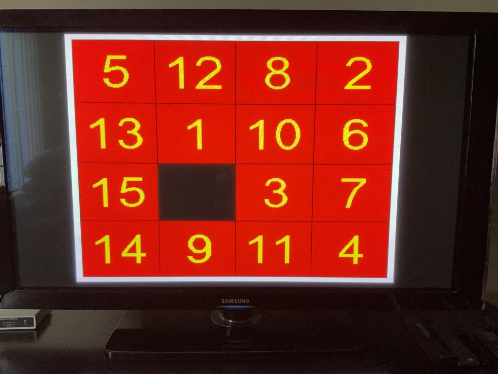

I briefly backtested on the CMM2 with a VGA->HDMI->USB3 link.
