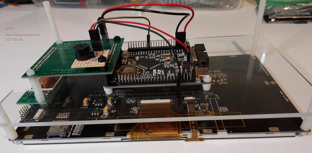

Below is an image of the "production" usage. The LCD is face down and I am using a 3mm sheet of acrylic as the "base" which everything attaches to for good connection stability. The adapter board is actually in 2 parts - one part (larger green piece) has the connector attaching to the 32 pin F4 connector, the second part (smaller green piece) is on the other side of the acrylic base piece and has the 40 pin connector attaching to the LCD screen. The two parts use stiff bare copper wires (salvaged from some mains power cable) for the interconnections. This allows the spacing between the two pieces to be varied according to mounting requirements.

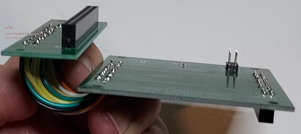

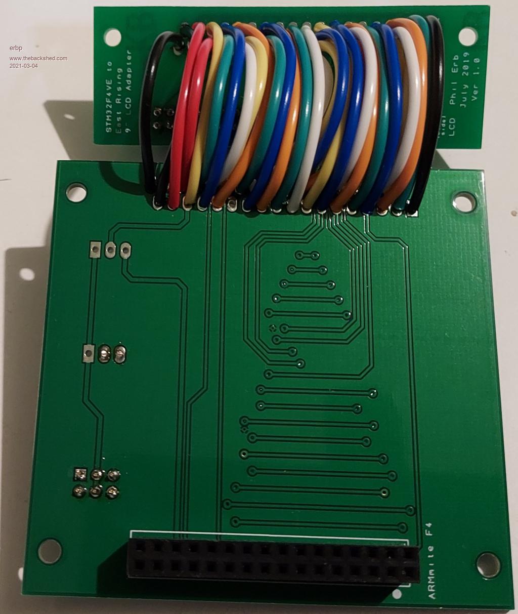

Below are two images of the "development" usage adapter (sorry I don't have a spare F4 or 9" LCD so can't show it connected up but I think you can get the idea). So instead of using stiff straight interconnecting wire, it uses flexible, insulated hook-up wires long enough to allow one piece of the adapter to be flipped over at 180 degrees relative to the other piece. This allows both the screen and the F4 to face upwards and provides unhindered access to all the F4 I/O pins as the F4 is positioned to the side of the LCD not underneath it.

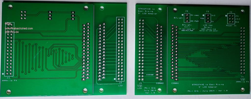

Below is an image of the adapter PCBs as created by the PCB manufacturer (one flipped to show the opposite side). The two pieces of the board need to be separated by sawing with a fine tooth hack saw along the line marked on the silk screen.
Care needs to be taken to ensure the 32 pin and 40 pin connectors are fitted on the correct sides of the boards - the side with the rectangle outline marked on the silk screen - left hand PCB image). Also the mating of the two pieces must be done carefully to ensure the correct interconnecting pads line up - match the two Pin 1 (rectangular) pads on CONN1 and CONN2, then the rest should be ok as long as you have the two pieces of the boards both facing the same way (i.e. both sides with the connectors fitted facing up). Follow the notes on the silkscreen of the board re power supply and backlight connections/settings.
