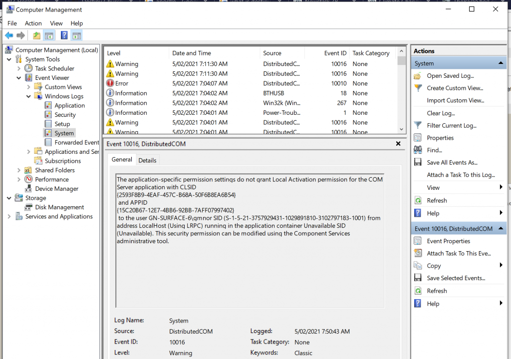

Have you tried looking at the "system" logs which are found in the "Event viewer" which is found in "Computer Management"
They take a while to be displayed under normal circumstances so with a slow machine it will probably take a while longer.
Start by looking for things flagged in red.

@ GlenO: Hello fellow Kiwi!  Had not thought of that, so I will try to see if I can get anything useful out of that - but it might be impossible, as the START menu refuses to open, so I can't actually select Computer Management in the first place...
