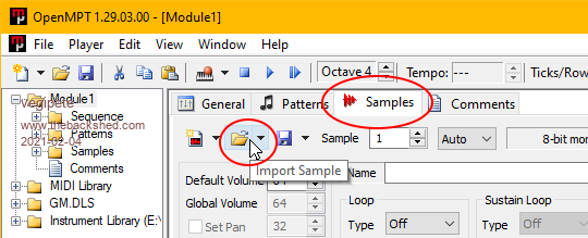

Now it's time to play with OpenMPT.
Start OpenMPT. (I've got version 1.29.03.00)
Start a new ... whatever it's called:  File --> New --> MOD
The new module opens, and the 'General' tab is selected.
Switch to the 'Samples' tab and load your wave files:
Select a wave file to load it. This will get loaded as sample 1.
Change to sample 2, load the next one. Repeat as required. (If you don't change the sample number, each one you load will replace the previous one.)
Also, there are a bunch of samples included with OpenMPT. You can find them in the MIDI Library and GM.DLS folders on the left side of the screen. Drag individual sounds to a _blank_ sample to include them.
Take note of which WAV is put in which sample number - you'll need this later.
You can listen to each sample quite easily. Select the sample number to hear, either from the sample number box, or with a click on the sample name on the left. The three rows of letter keys act as 'piano' keys. 'A' and ']' are close to 8000 Hz. 'N' is near 22 kHz. (Press 'Esc' to stop sounds that loop.)

yock1960
Joined: 18/08/2020
Posts: 167
Posted: 10:28pm 04 Feb 2021
vegipete...you are the man! Works beautifully and much tidier than a bunch of individual files!
Thanks!
