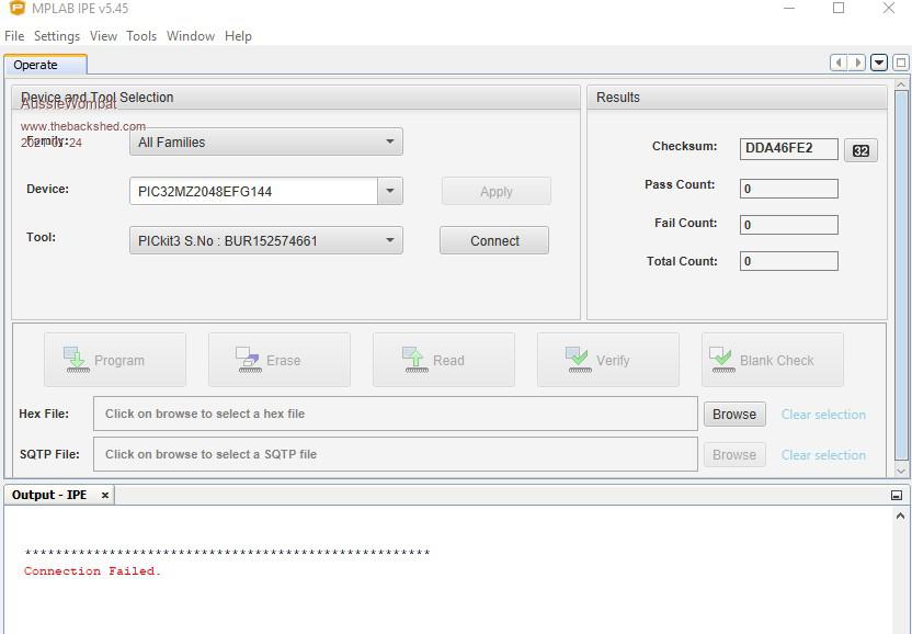

Tried to update firmware to 5.05.03 but my pickit3 refused to connect under MPLABS IPE 5.45 , running x64 Win10.

I selected the Pic32MX470F512H as the target chip, and connected the pins to the pickit3 that circuitgizmo had set on this page at the bottom.
Should the led blink? When I supply the target with power, after all the connections are made to the MCLR, VCC, VDD, pin D9 and Pin D0, as there is no ICSP header.
The pickit3 has all three led's lit at first, then the status led goes out. The IPE still recognises the pickit3, but fails to connect. I am connected to the rear USB port, not a hub.
I just plugged the pickit3 into my computer with no pins connected, and the computer says the last device failed. In the device manager it says, device descriptor request failed. When unplugged, then re-plugged all is ok.

  Quote  The IPE still recognises the pickit3, but fails to connect.
Fails to connect to what? The PICKit3 or the chip?
What is the exact error message?

mplab x ipe finds pickit3 just won't connect to device

gonna add a pulldown on signal line and try again tomorrow. Was working on V5.2
pic was from trying to update micromite extreme 144

It would be helpful to have the full output from IPE with the correct chip.  Normally the error is "Target Vdd not detected" or "Cannot read device ID".
Regardless, the PICKit3 and MPLAB X IPE do work perfectly on the CGMICROBOARD2 so it must be something you have wrong.  It could be incorrect wiring, a load on PGD and/or PGC, a capacitor on MCLR, poor power on the target, etc.  The list is endless and you will just have to start troubleshooting.
Pulldowns (or pullups) on PGD or PGC are not needed and will probably introduce another source of errors.

I am going to post this in stages, as it says I have special characters like emoji's in it. I want to break it up so I can tell which section it is picking on.
  Quote  It would be helpful to have the full output from IPE with the correct chip.  Normally the error is "Target Vdd not detected" or "Cannot read device ID".
The picture I posted looked the same when I selected the PIC32MX470F512H as the target chip.
  Quote  Regardless, the PICKit3 and MPLAB X IPE do work perfectly on the CGMICROBOARD2 so it must be something you have wrong.
I would probably agree.

The settings I used were on the bottom of the CGMICROBOARD2 Technical Info page I linked to before.
Quoted from page:(It must have been a character in this quote that I copied from the page. Ok Once I re-typed it)
  Quote  Firmware Updating:
There isn't a programming header, but the programming pins can still be connected.
The Pickit3 Header:
1 - MCLR - RESET
2 - Vcc - 3.3V
3 - GND - Ground
4 - PGD - uM16 (Arduino header D9)
5 - PCC - uM15 (Arduino header D1)
Jumper wires can be used to make these connections and then the board programmed via PICKIT3 software.
  Quote   a capacitor on MCLR, poor power on the target,
I'm not sure on the capacitor, but the PSU is a 12V, 1.5A Transformer.
  Quote  Pulldowns (or pullups) on PGD or PGC are not needed and will probably introduce another source of errors.
I did not imply I was using a pulldown when using the Pickit3. What I meant was, I am going to try using a Pulldown on the signal line from the Hall effect sensor output to minimise errant signals.
I will have to try and see what is going on with my pickit3.
Should the led blink when in programming mode, and attached to pickit3, and power?

Now if I can only work out what I am doing wrong with my pickit3. May have to contact CircuitGizmo for some advice.

P.S. I also got the updates to work between my Pickit3 and MM+, so everything now ok.
