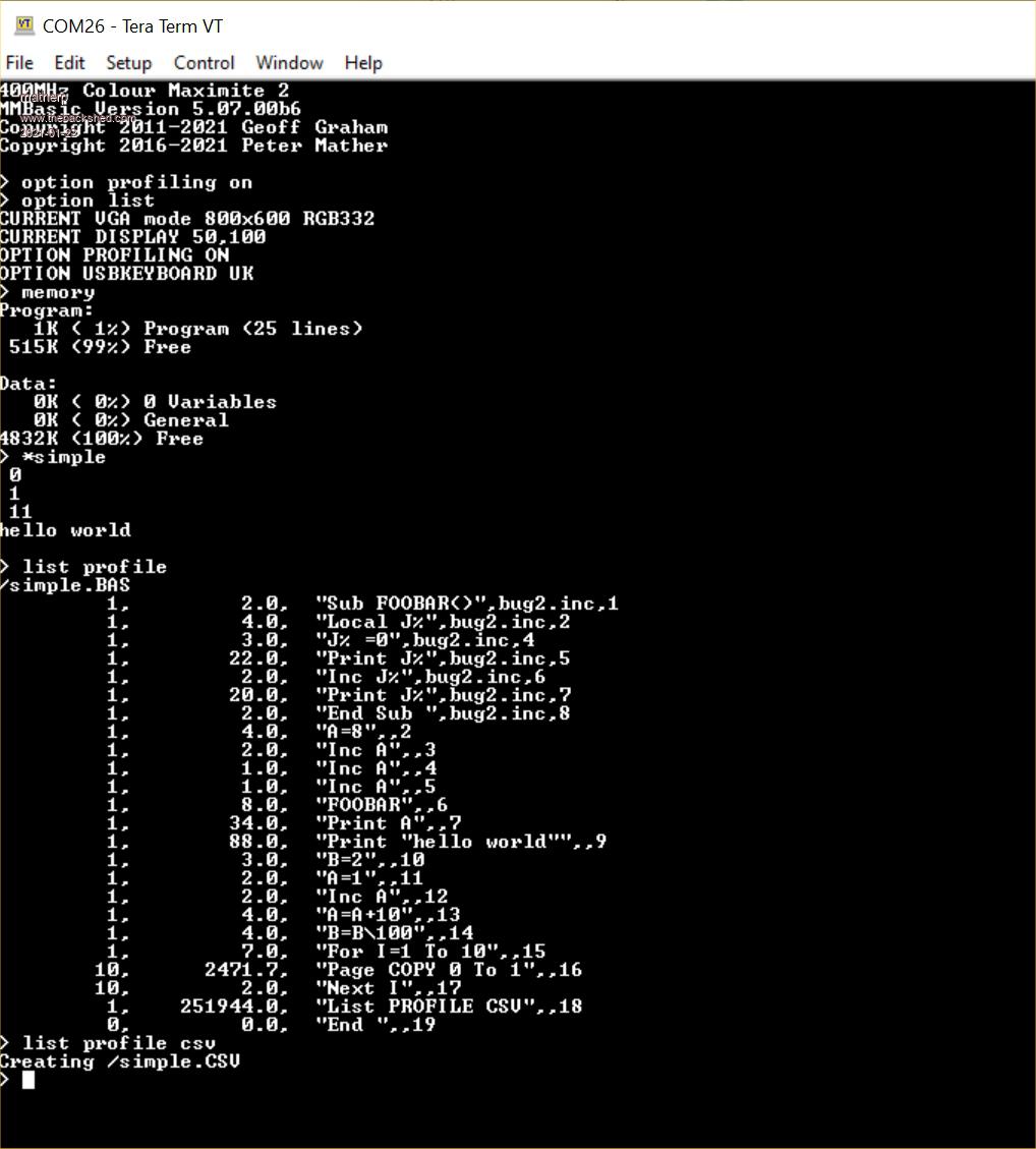

Please download and try V5.07.00b6
http://geoffg.net/Downloads/Maximite/CMM2_Beta.zip
This has the following changes:
MODE 12 reverts to the original 960x540 where lines are duplicated in memory and the monitor sees 1920x1080 @ 60HZ
A new mode 14 is introduced which has the timings for 540P, still 960x540 but with no line duplication. If your monitor can handle it this is the best default mode for a widescreen monitor
The big change in this beta is a:
Program profiling capability
To turn on or off the profiling use
OPTION PROFILING ON
OPTION PROFILING OFF
This is a permanent option but it defaults to OFF whenever new firmware is loaded. With profiling on you will see a performance impact of about 5% caused by the profiling data collection which happens at the MMBasic statement level. In addition you will see a reduction in available variable RAM of 512KB. Note that profiling and OPTION RAM are mutually incompatible.
With profiling enabled you can run your programs as usual and you should see no change in behaviour other than as mentioned above. You can see the way the program has run using the commands
  Quote  LIST PROFILE
LIST PROFILE CSV
Some sample output is displayed above.
There are 5 comma-separated fields in the output
The first field is the number of times a given statement has been run
The second field is the average time in Microseconds taken to execute the statement
The third field is the crunched statement as stored in memory. This is quoted to make it easier to load into excel etc.
The fourth field is the filename in which the statement appears. This is blank if the statement is in the main program, otherwise it gives the filename of the include file in which the statement is to be found
The fifth and final field gives the line number of the statement in the source file.
When LIST PROFILE CSV is used a file is created in the same directory as the main program with the .BAS extension replaced with .CSV
LIST PROFILE can only be used at the command line
LIST PROFILE CSV can be used in a program allowing you to create and rename multiple files while a program is running if required
A program can test if OPTION PROFILING is enabled using
MM.INFO$(OPTION PROFILING)
This returns a string "On" or "Off"

Posts: 6631
Posted: 06:02am 25 Jan 2021
Profiling is unreliable immediately after an AUTOSAVE
Using your simple example code I first did an AUTOSAVE
then <F2> to re run the program.
I also tried NEW before the AUTOSAVE but still not correct.
Every time I do subsequent runs with <F2> seem to be consistent.

Posts: 12074
Posted: 08:19am 25 Jan 2021
The profiling buffer is cleared by the RUN command. Autosave doesn't use the run command so I need to add the clear to AUTOSAVE. In the meantime exit AUTOSAVE with F1 and then type RUN
UPDATE
V5.07.00b7 updated and re-uploaded
