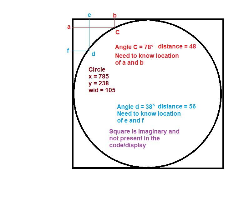

I have a circle on the display and I want to place pictures on the outside and inside in certain locations
I know the X Y and Width of the circle and I know the Angle of where I want the items placed
Is there a formula or easy way to work out where to place the pictures?
In this case it's a compass and the pictures are direction words like NE,NNE etc
the text in the images is rotated to the correct angles I just need to find a way to work out where to place them
an example
place image 1 at 21 degrees and distance is 43 from the centre of the circle
Is there any formula? to work out the x and y positions to place the image?
an image that hopefully explains what I mean
the square outside isn't there I drew it so it's easier to explain what I meant

If 785,238 is the center of the circle and the diameter is 105 (radius=105/2), then
a = 785 - 105/2, 238 - (105/2)*sin(78*pi/180)
b = 785 - (105/2)*cos(78*pi/180), 238 - 105/2
e = 785 - (105/2)*cos(38*pi/180), 238 - 105/2
f = 785 - 105/2, 238 - (105/2)*sin(38*pi/180)

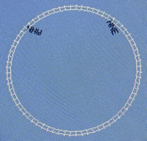

It still displays them at 45 and 315 degrees instead of 22.5 and 67.5
Text 10,10,"NNW",L,7,,RGB(1,1,1),RGB(134,174,230)
Image rotate 6,4,29,29,cx%-(wid%-16)*Cos(.785),cy%-(wid%-16)*Cos(.785),22.5,1
Text 10,10,"NNE",L,7,,RGB(1,1,1),RGB(134,174,230)
Image rotate 6,4,30,30,cx%+(wid%-16)*Cos(.785),cy%-(wid%-16)*Cos(.785),67.5,1
Text 10,10,"  ",L,7,,RGB(134,174,230),RGB(134,174,230) ' clear text

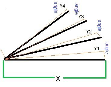

What I'm trying to understand is this
If I know X AND angles 1,2,3 and 4 How do I calculate what Y is for each one?

Excuse my crude quarter circle (of radius R), but the (x,y) coords for the angle (ang in degrees) is:
     --\ (x1, y1) <- want the coordinate at this location for the angle (ang1)
    _/  --\
  _/       |
/ ang        |
   R = radius
x = R*cos(ang_deg * pi/180)
y = R*sin(ang_deg * pi/180)
So, in your diagram, X looks to be the radius, and the heights for Y1-4 would be
y1 = X*sin(ang1 * pi/180)
y4 = X*sin(ang4 * pi/180)
Of course, in screen coordinates with Y increasing down the screen, you would subtract these Y values from the starting point.
And the X locations on the outside of the circle would be (again with 'X' as the radius)
x1 = X*cos(ang1 * pi/180)

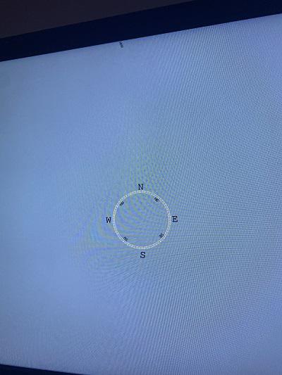

It prints the new ones a the top of the screen

I can't see why it isn't placing them where they should be
