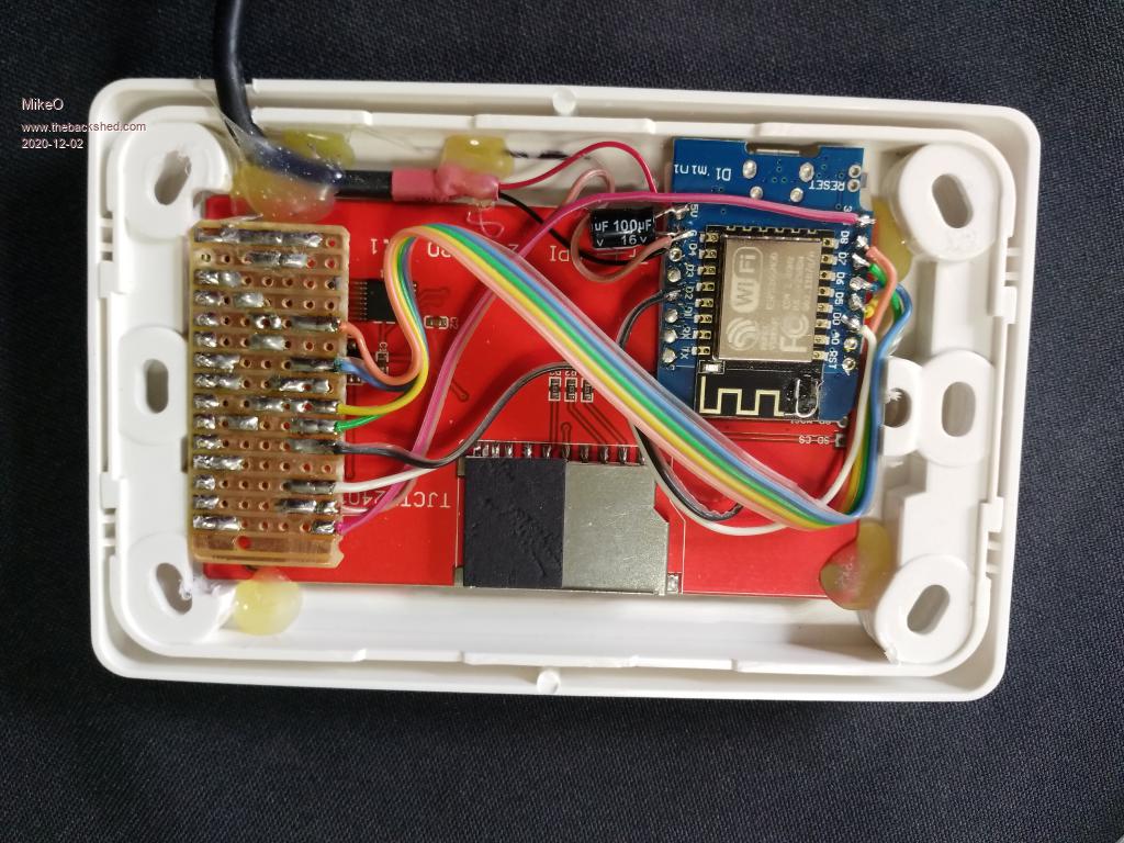

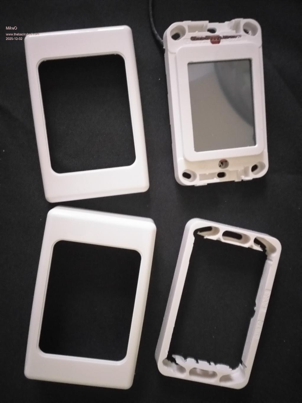

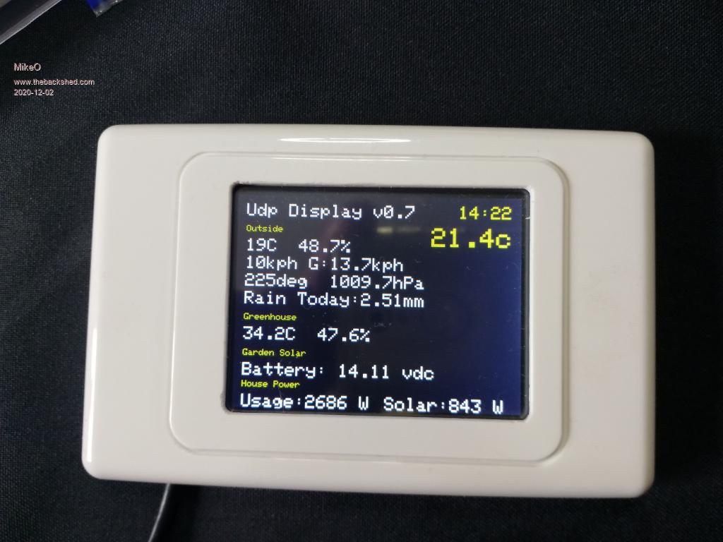

I needed some wall displays and wanted them to match if possible power and switch outlet housings around the house. I have seen similar commercial housings used previously on the forum see here. I have a small milling machine so decided to experiment and this was the result. I used blanking wall plates and commonly available in Australia/NZ see, if you need more depth (or don't want to make a hole in the wallboard) there is a deeper mounting block that can be added see. The result is quite pleasing.
This pair of photos shows a 2.8" display mounted in a normal wall plate just 13mm deep. In this case a ESP8266 D1 Mini is driving the display but it could be micromite etc. For simplicity there is small slot outlet for the usb power lead for total surface mounting but you could also bring the power via the wall of course.
If you need more depth a mounting block can be added to the basic assembly to give you more depth.

That is a nice looking project.
UDP data flow.. nice and fault tolerant.
