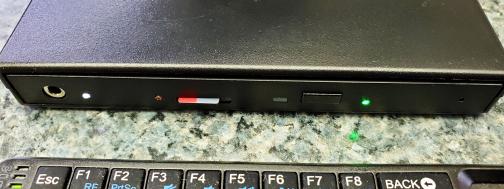

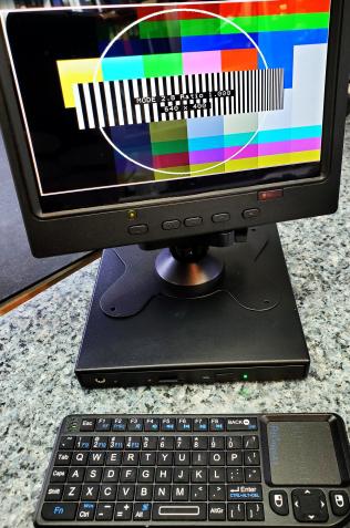

When I created the RetroMax (CMM2 compatible) I wanted to put it in a unique case and made this:

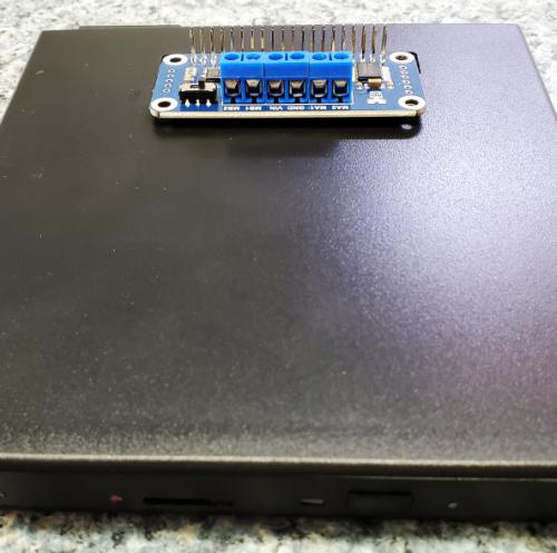

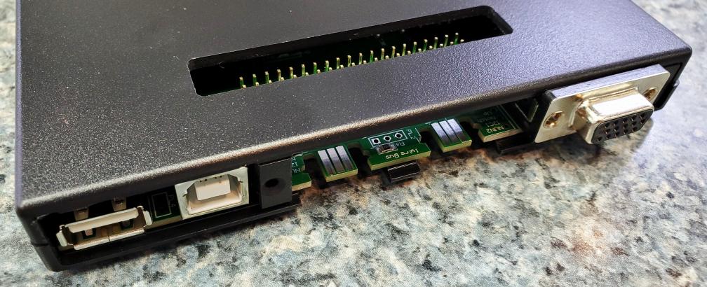

Most people have purchased the RetroMax in this enclosure. You can add the rPi "HATS" through the slot in the top:

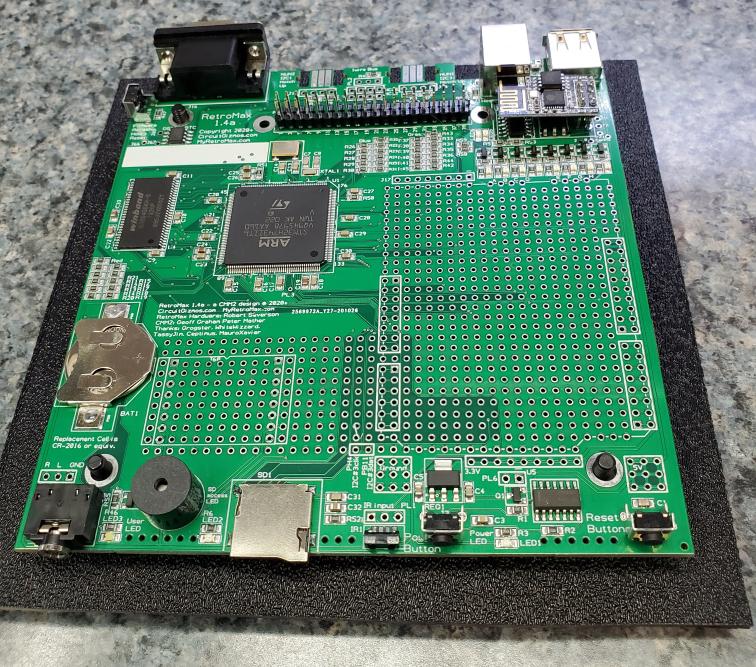

But I also wanted some way for hardware enthusiasts to use the RetroMax and build hardware directly on the board. So I made the sea-of-holes for the RetroMax (just like I did for the CircuitGizmos version of the CMM1)
I also wanted something a bit more than just a bare board set on a surface. But also not something too elaborate. I think that a simple base like this would work well:
More complex would be a version with a solderless whiteboard attached. But I don't think that has a wide appeal.
What does everyone think?

The sea-of-holes supports - toward the right in the picture - a place for an Arduino shield, although there are no hard connections to the CMM2 processor. Just an extra set of holes to facilitate wiring in some connections. Also there is a group of holes offset, just like the Arduino.
Same with the MikroBus area. Nothing hard-wired except 3/5/gnd.

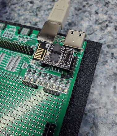

Adding any modules (MikroBus / Arduino Shield / ESP8266) could happen within the case only if the modules are very slim. So the "naked to the world" open PCB on the base is a reasonable approach.

  CircuitGizmos said  When I created the RetroMax (CMM2 compatible) I wanted to put it in a unique case
Is that a portable DVD housing?  Looks funky, although I was warned off having Nunchuk connectors without a surround (risk of putting in upside down, stability etc.)
CircuitGizmos
Joined: 08/09/2011
Posts: 1427
Posted: 08:45pm 10 Nov 2020
Yup! It's a DVD case. I like how thin the case is.
The Nunchuk plugs in "notch up" on the RetroMax.

  CircuitGizmos said  More complex would be a version with a solderless whiteboard attached. But I don't think that has a wide appeal.

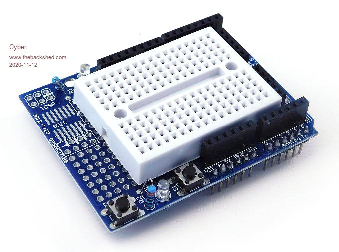

I use this thiggy with my CMM1, so I vote for integrated solderless board.

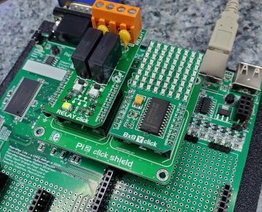

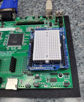

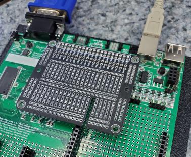

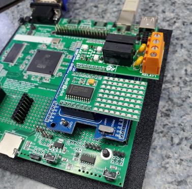

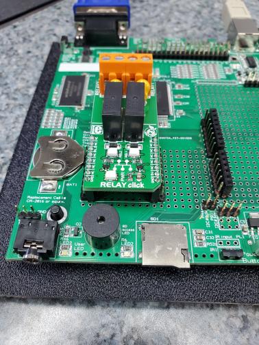

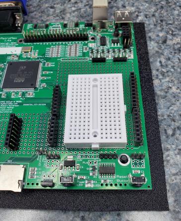

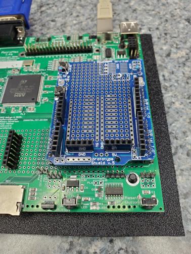

Here are examples of using the base plate with the RetroMax 1.4a for adding MikroBus modules, Arduino shields, and rPi HATS.

  CircuitGizmos said  Here are examples of using the base plate with the RetroMax 1.4a for adding MikroBus modules, Arduino shields, and rPi HATS.
Nice examples.
I agree that sea of holes is more practical solution than integrated solderless board.
User can choose if he wants to use sea of holes directly or attach solderless board on top of it.
