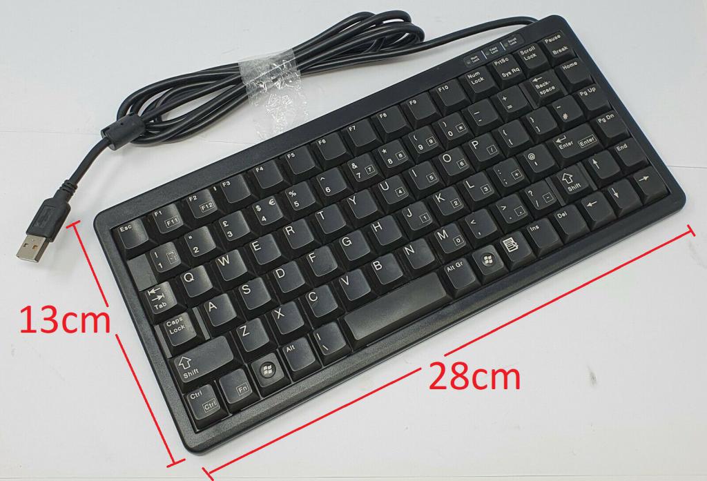

If you are short of deskspace I sometimes use a Cherry Compact G84-4100 Mechanical Keyboard, which I have tested and seems to work fine with my CMM2 (once Peter patched the Firmware).
Note for some reason the status leds do not work on this keyboard, some keyboards can be quirky with the CMM2.

Mechanical Cherry Keyswitches not good enough ?
Ok I admit they are only Cherry ML, but still, that aint no rubber dome board   and its space savingly cute

That keyboard you posted is pretty sweet...and temping :)

The G84-4100 being so small is just for those times when serial wont cut it

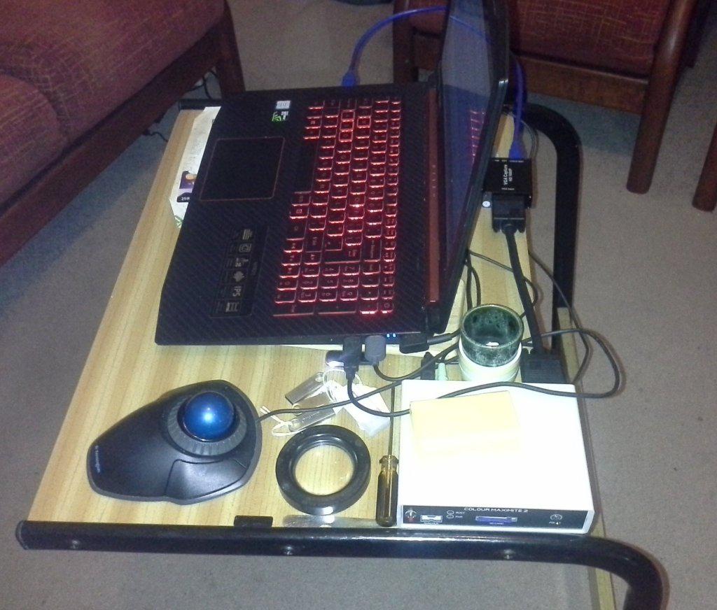

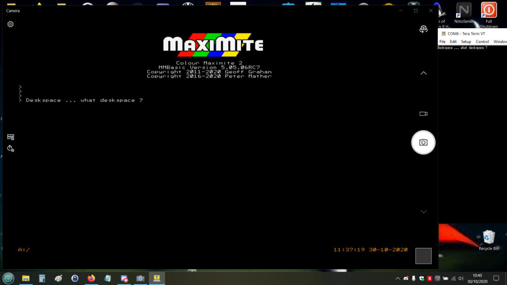

Desktop Space ... What is this Desktop Space of which you speak ?
This is my "Living Room" setup.
I have a second CMM2 setup in the workshop with a monitor and keyboard, but for coding in front of the telly I use the VGA Capture device to display the screen on my laptop, and enter text using TerraTerm via the laptop keyboard.  Very Compact.
My eyesight survives unless I code too much
Womble

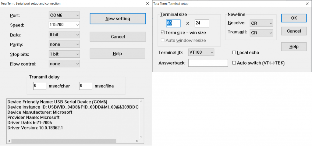

  Krall said  I couldn’t quite get serial terminal to work right on the CMM 1 so I’m hoping on the 2 that just arrived (thanks Circuit Gizmos!) fairs better. I still like your video capture idea best. That would make everything remote and I’d still be able to use video.
Here are the TerraTerm settings I use.  The serial connection passes over the USB A-B cable which I am using to power my CMM2 from the laptop.
Video obviously goes via the VGA Capture Device (blue cable in my photo)
And yes, that Laptop keyboard is hideous

  Womble said  For coding in front of the telly I use the VGA Capture device to display the screen on my laptop, and enter text using TerraTerm via the laptop keyboard.  Very Compact.
Womble
If Siwypiotr is reading this I can see a Maxitop before the end of the week!

Lol Womble for a second I thought you had a Maximite Laptop!
Thanks for the settings, I'll try it. I had to order a microSD card as my RetroMax uses that which I didn't know. I also ordered the video capture device.
EDIT: Genius Womble! Those TeraTerm settings got me right in! I was using other settings from the board that I found which did not work :)

  elk1984 said  If Siwypiotr is reading this I can see a Maxitop before the end of the week!
Interesting suggestion.  I seem to remember others suggesting a portable CMM2 might be nice.
The advantage to my setup is that you can have the manual pdf open for reference.

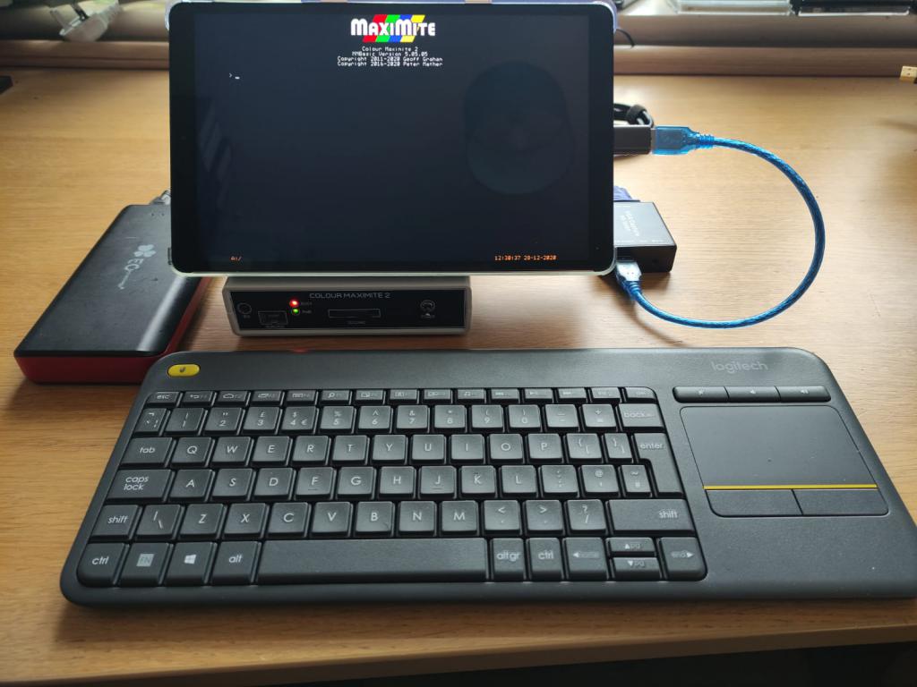

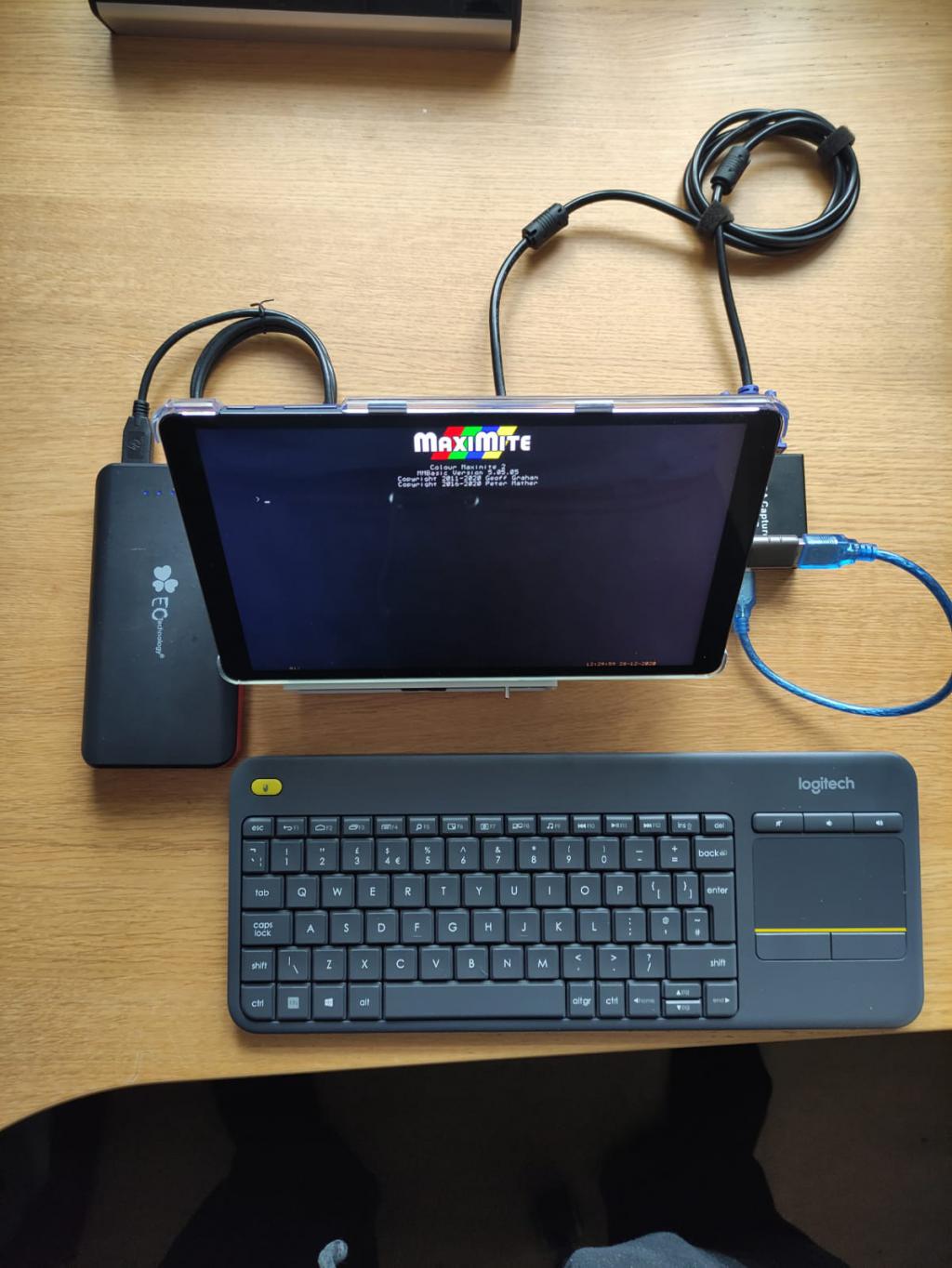

For those looking for a "portable CMM2", this could be interesting.
(The blurring is my dodgy photo taking, not the signal to the tablet)
I used the USB Camera app from the Play Store.  I upgraded to the Pro version £5, but the free version works pretty well providing you don't mind adverts.
I had to change my screen settings on the tablet.  I'm still experimeneting, but YUV2 800x600 @ 20FPS seems good for basic editing)
Original inspiration from ETA Prime
Edited 2020-12-28 22:27 by elk1984
