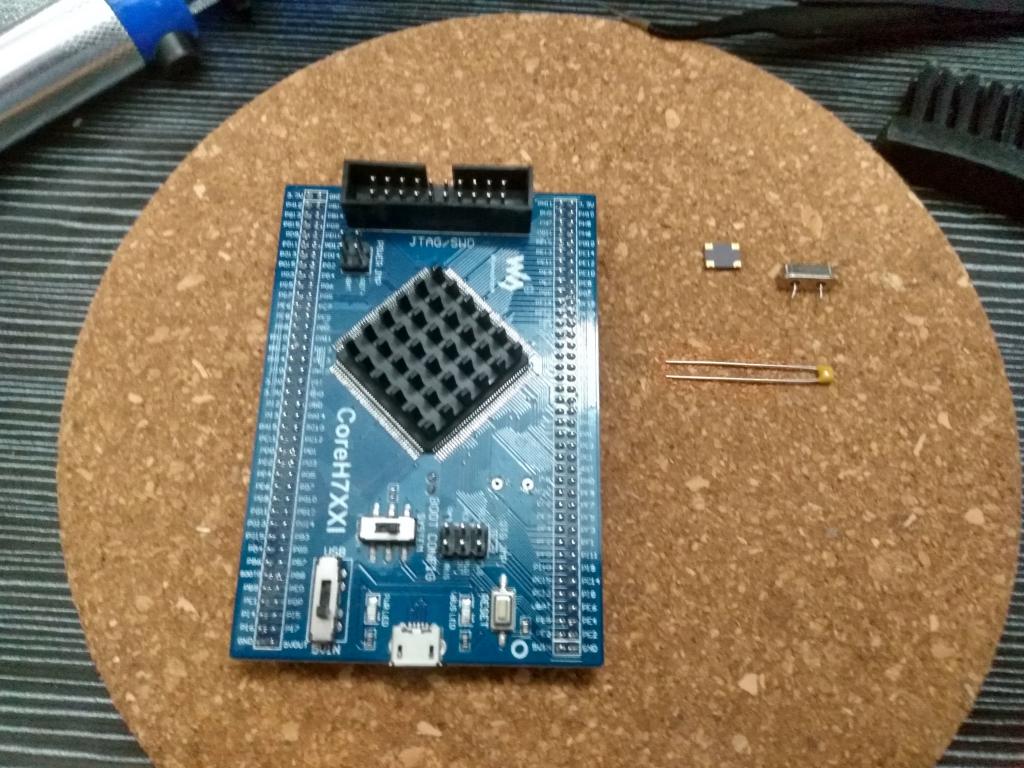

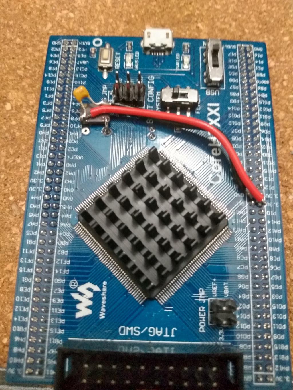

Hey
I've ordered the capacitor and crystal.
When they arrive I'll make the mod and check if will solve the problem :D
I'll let you know when I complete the tests with the mod.
Thank you for all you help

Thank you for all your help.
Problem 100% fixed, all modes working perfectly.
