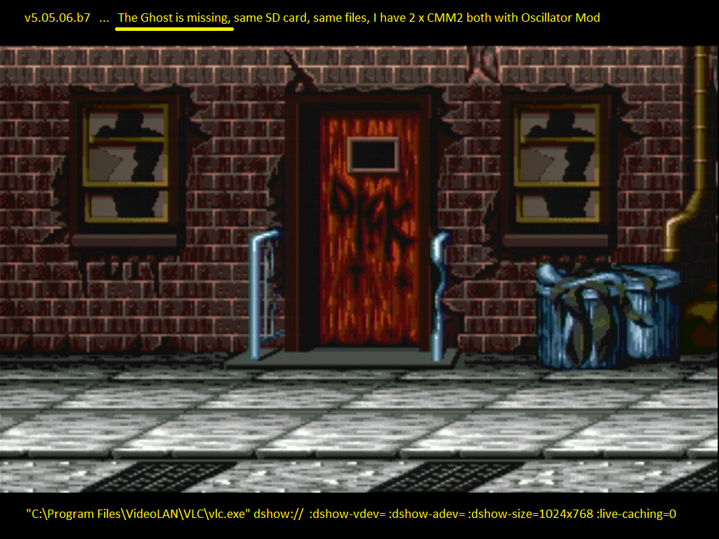

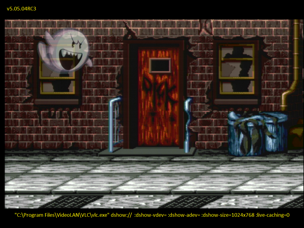

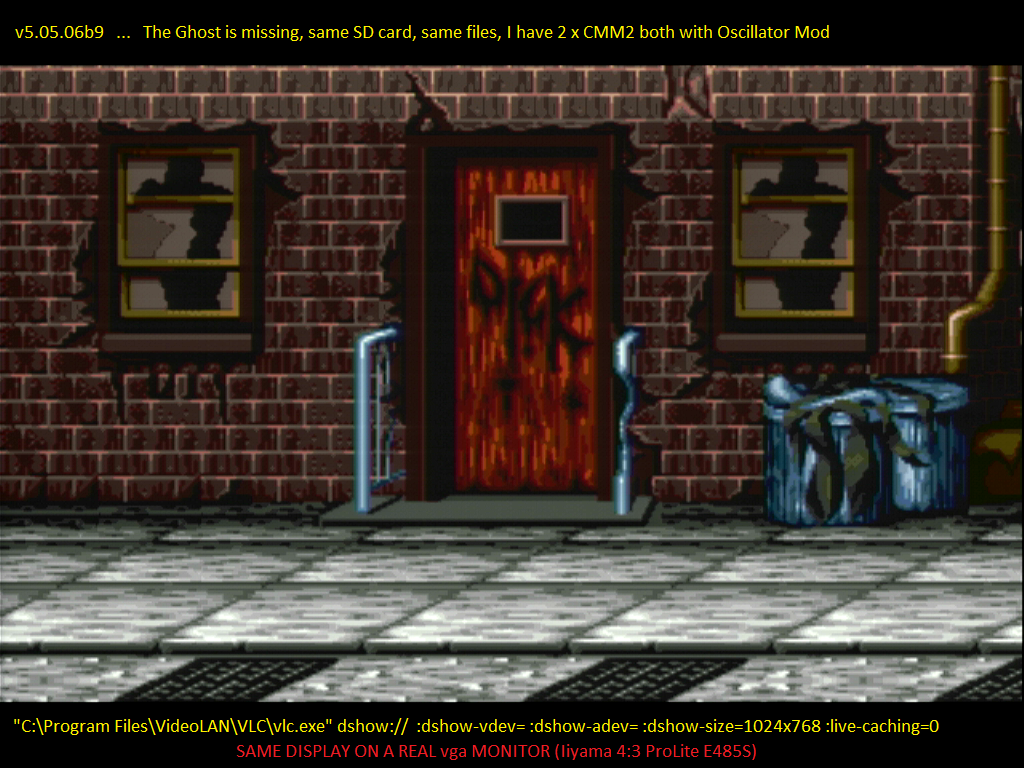

Posted: 10:05pm 19 Sep 2020
Peter,
Many Thanks for your work on this but I seem to have found a bug on the last few firmware releases whilst I have been testing the VGA-->USB2 Video Capture device.  These also show up on a real monitor (Iiyama 4:3 Prolite E485S) on both my CMM2's.
When it worked: V5.05.04RC3
No Ghost
Still No Ghost
The program I am using to test this, basically your code from this post which I modified to change to a directory where the files are located, and to exit cleanly when ESC is pressed.
Here is the code I am testing so you can replicate the problem (minus the MP3 of course, I include a text file showing the spec of my HOTEL.MP3)
Ghost Demo.zip
Maybe I have done something stupid, but I am surprised no one else has found this one.
Sorry
Womble

Posts: 12083
Posted: 07:56am 20 Sep 2020
  Quote  When it worked: V5.05.04RC3
Thanks for the report. Now need to understand what I have broken
Edited 2020-09-20 19:45 by matherp
