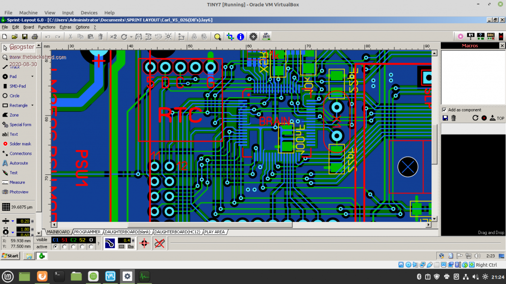

Posts: 10075
Posted: 09:32am 30 Aug 2020
We're getting there now!!!!!
This is the Win7 VM running under Mint, with one of my PCB designs loaded.  Mouse-wheel scrolling is EXCEPTIONALLY good.  The old hardware I tried last time, was lagging.  This new NUC hardware only maxed to about 15% CPU when zooming with the mouse-wheel, which is normally CPU intensive even in Windoze.
I don't really care about being able to access USB specifically, I just needed a way to move files from Mint to the VM Win7 and vise-versa.  The drag-and-drop seems to be working OK, so that is a method I am happy to use.  The VM Win7 does not see my network printer.  Not sure if there is anything that can be done about that - would like to, as I often print what I am working on to check for basic dimensions etc.
The image is a little odd-looking, as I only have an old relatively low-res monitor connected.  I will try an experiment tomorrow, by connecting my dual HDMI monitors to this box, and playing about some more.
This is really encouraging though, as previously, what stopped me moving to Mint, was that the Windoze emulation was slow.  This was probably due to the older hardware, to be retroactively fair to Mint of then, vs what I am playing with now.
The tinkering will continue tomorrow.

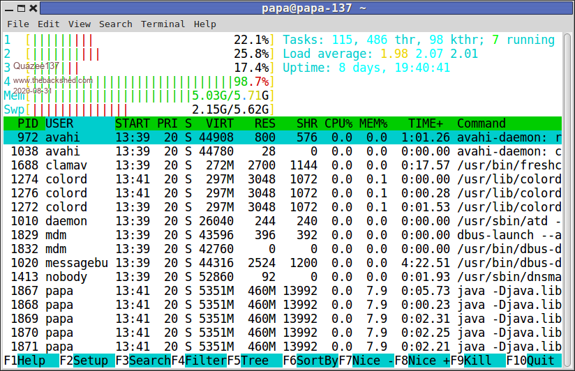

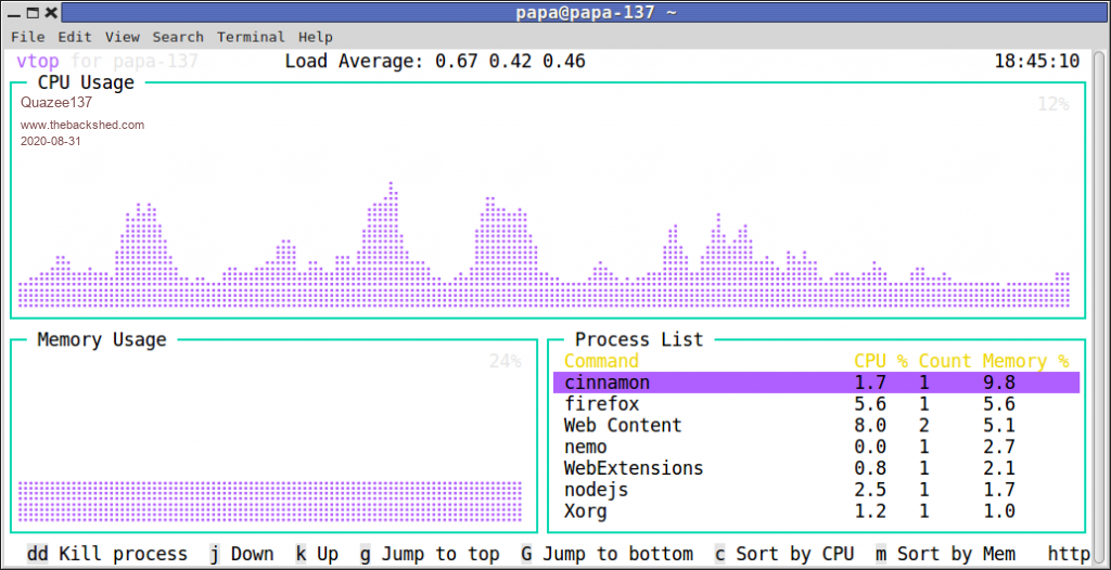

I use htop  there is also vtop I have not installed it yet as I'm getting ready to
move from mint 18.2 to 20 on my new box.

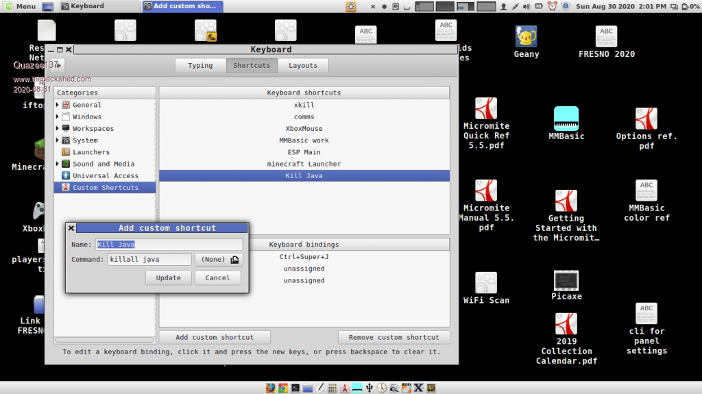

 and I have hot keys to kill java when minecraft locks up.
couldn't wait so loaded up vtop very nice look to it.
