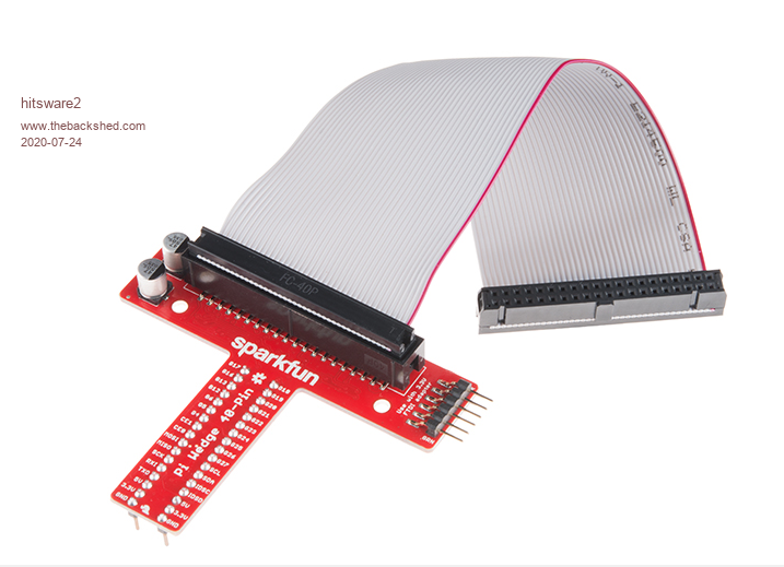

Will one of these fit the CMM2 ?

  hitsware2 said  Will one of these fit the CMM2 ?
Yes it should... Same 40 pin connector and (IIRC) same pinout as the pi has.

Posts: 6631
Posted: 03:18am 23 Jul 2020
Just make sure that the pins end up the right way around.
If your CMM2 has a shroud around it's 40 way connector, it is likely to have the cutout on top.
This will cause the cable to connect the wrong way around.
The easier fix is to attack the shroud with the side cutters and put a cutout in the bottom.
This lets pin1 go where it should.

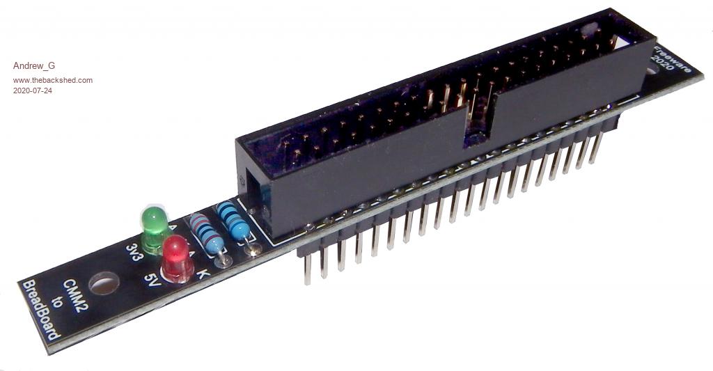

Or you might be interested in one or both of my Breadboard designs I advertised in my COMMERCIAL thread here. Up near the top of Page Number 7. The Breadboard version doesnt take up as many holes in on the breadboard as the one you linked to.. The header is the correct way around for you for the CMM2 as well.

  TassyJim said  Just make sure that the pins end up the right way around.
Whew .... Thank You .... How did that happen ?
It will be this one ...
my site
Posts: 6631
Posted: 04:13am 23 Jul 2020
Unless it's changed, that one doesn't have the shroud.
Just keep pin 1 of the cable adjacent to the VGA socket.
The RPi breakouts tend to connect all the GNDs together as well as all 3.3V and 5V.
Not a problem as the CMM2 (deliberately) uses the same pins but not good if things go back to front.

  TassyJim said  The easier fix is to attack the shroud with the side cutters and put a cutout in the bottom.
But that would still leave the possibility of inserting the connector around the wrong way   Wouldn't it be better to remove the cable connector and reverse it?
If the breakout is meant for  RPi shouldn't it be correct for the CMM2? Of course you should double check before connecting anything to it!

I have one of the OP's items (I bought it in Aus. from Jaycar). Another problem with them is that, because of their width, they consume a lot of your breadboard. (because of that I haven't used it in anger - preferring to use Mick's).
I now have several of BigMik's Breadboard designs. They only take up one column each side of the centre leaving you plenty to play with.
Mick has also sorted the pin 1 to pin 1 issue (so I just use the 40-way female to female cable that came with the OP's device).
As Tassy Jim says you can get the 40-way cables most places or I now make them up with IDC connectors and cable.
Here is a pic off BigMiks website and you can see that the pins are a minimum distance apart for the breadboard (you can only see one row of pins - the other is only 8mm - 5/16" away).
Cheers,

  hitsware2 said  I noticed after I posted ....Here's the one I ordered ...
Yes but that is the wide version that loses a lot of breadboard area..
Why would they do the 34 pin with a small width but go and make the 40pin one with a wider (0.6”?) width?
Seems dumb to me..
I admit I would prefer the cable horizontally but it isn’t that difficult to fold the cable so it is not really in the way.
If you want any of my PCBs I am happy to send you some, Postage (pre Corona) was typically 7 days from Aus but that has drifted to more like 14 days..  But the postage is a fickle thing..
PM. Me if interested in my version..  At least you dont have to worry about the orientation of the notch on the header as mine were designed with the CMM2 in mind..
