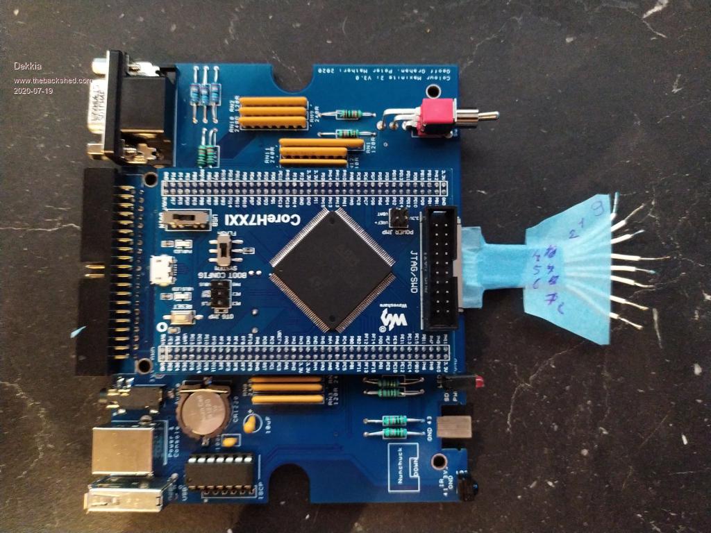

My Colour Maximite 2 does not detect SD Cards Properly.
I already Tried the following:
- Re-Solder the SD Card Slot [1]
- Removing the Card and putting it back in (sometimes fixes it, but unreliable)

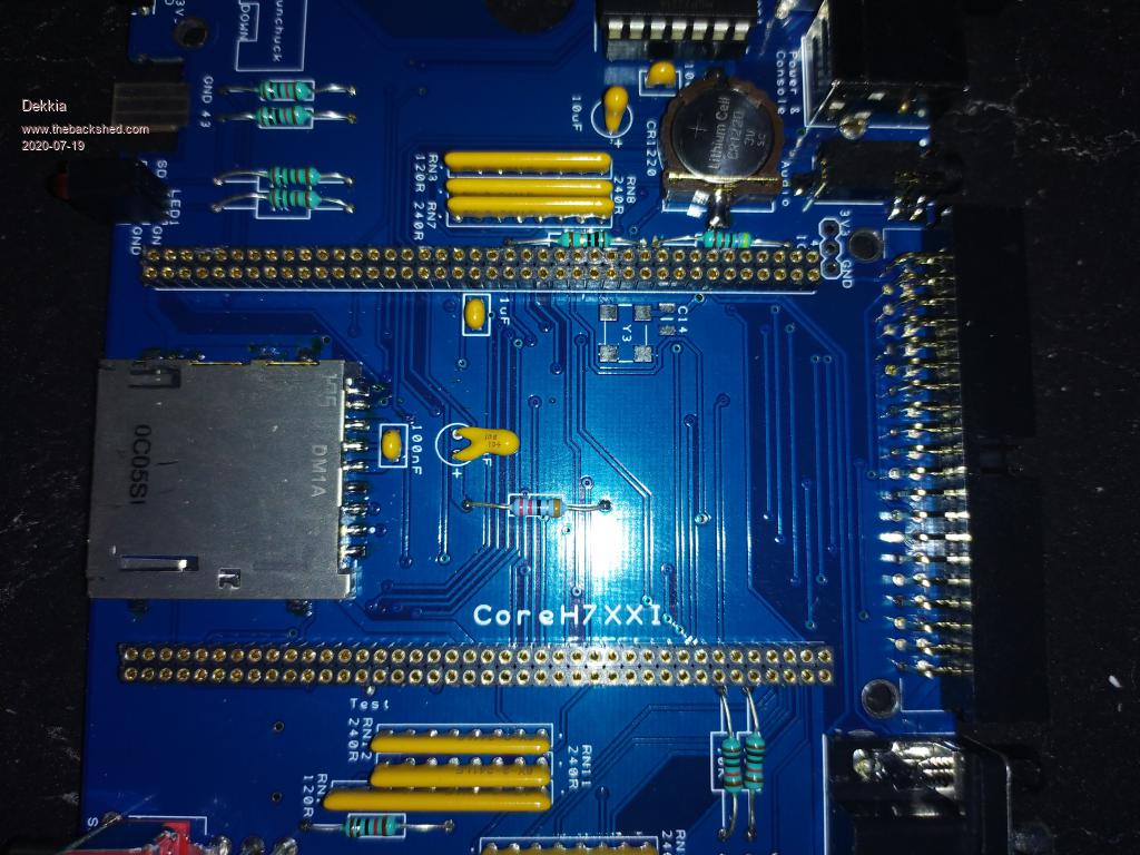

- Use A Multimeter and a SD Card Breakout to check for continuity according to the schematics from the Construction Pack.[2] (CARD_PRESENT and CARD_WRITE_PROTECT are always GND)

I'm out of Ideas on how to fix it. It worked for a while after soldering everything together but stopped working from one second to the next.
The rest of the computer works just fine.

If it works sometimes then it is probably mechanical. Try levering up on the front of the card to force the contacts down. Or try some tape on the top rear of the card. It is possible to solder the card sockets such that the back where the contacts are isn't flush to the PCB and this stops the contacts making reliable connection.

Use a magnifier to check very carefully along the left side of the SD socket (The top edge in your first photo).  In addition to the "mounting feet" there are two very tiny contacts that must be soldered to the PCB.  These contacts are extremely close to the metal shield and difficult to see let alone solder.  If one of them isn't tacked down good or if there is the possibility of shorting one to the shield this might cause intermittent issues.
