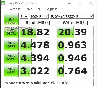

However, I bought a couple of these cheap 4GB ones, that I just wanted to use to boot Puppy Linux boxes running SAMBA NAS file servers.  I could no doubt buy 16GB or so drives of that physical size locally for about $15 or so, but I thought: "What the hell!"  I don't need more then 4GB to boot Puppy(actually considerably LESS then that), so in some ways it seemed a waste to use a 16GB flash drive, for a 2GB or so partition with Puppy on it.
They arrived in due course, and I tried one out, not really expecting much.
I was pleasantly surprised!
Not only did they have the capacity as advertised, but their read/write performance was not really too bad:
Now, the random-read and random-write speeds are in the toilet, but what interested me most was the sequential read/write speeds, and it is interesting to note that these things can WRITE faster then they can read!  Normally, read is faster then write.  Even on brand-name drives.  I have several Toshiba 32GB flash drives here, and they average 5.5MB write speed.  Anyway, with 20MB/s write rate, this is perfect for something like Puppy, which simply boots from the USB drive, then loads an image into RAM and runs that the rest of the time.  Random read/write is a non-issue with Puppy, due to the sequential read of the 'pupsave' file at boot-up, and also when/if you save the current session back to a pupsave file, that is also a sequential write, so these are perfect.
....and they only cost two bucks each for the 4GB ones, which is all I needed.

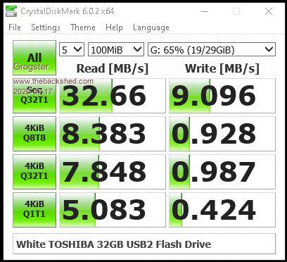

For comparison, here is the speed test for the 32GB Toshiba flash drive:
As you can see, the Toshiba drive wins on the read speed(as you would expect), but still only averages 9MB write speed, whereas the $2 one from AliExpress can write more then twice the Toshiba's speed - actually rather impressive for a $2 flash drive off AliExpress.    Toshiba is also better at random-read(again - as you would expect with a brand-name drive), but it is actually about the same for random write as the two buck one!  But then, I don't think ANY USB flash drive does very well with the random-write tests.  Correct me if I am wrong on that.

Did you run pattern checks to see what the actual working capacities are?
I've bought cheapies which turned out to be only 10MB or the like!

@ JohnS: I just filled it up with close to 4GB of data, and it did not complain, which is what they usually do if they are really a lesser capacity then what is advertised.
