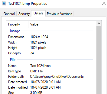

Edit:  For reference, here is my 1024px image properties:
Edited 2020-07-10 09:05 by GregZone
