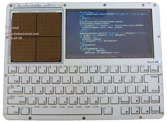

Posts: 6204
Posted: 07:11am 06 Jul 2020
Someone tried few years ago....
I was too late for the kickstarter, but still think (appart from the keyboard choice) this would have been great ..
Running MMBasic.. It basically is a TFT Maximite with prototyping area and 3 sd card slots running of LiPo battery.
The old kickstarter:
