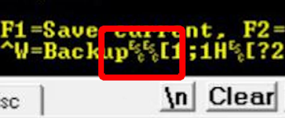

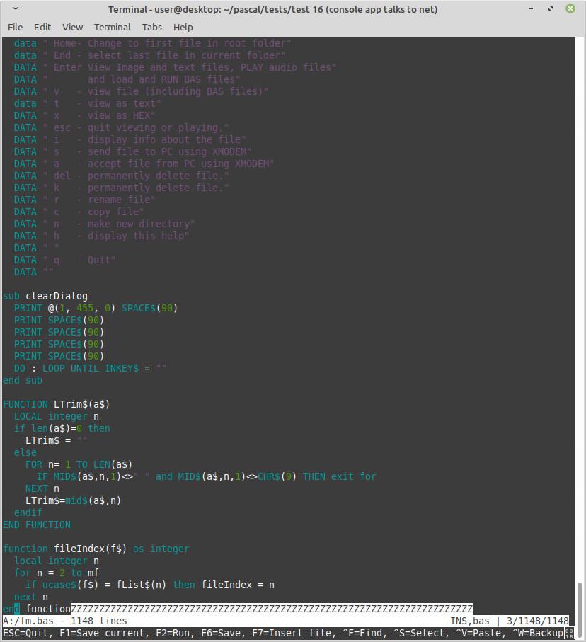

i take it you are using the sequence \033[8;50;101t to resize? it looks like upon exit, the terminal size is not restored - if desired the size can be read with \033[18t before the initial resizing.
i'm also seeing a hanging escape character in the bottom-rightmost character location, and what i'm guessing is a string of trailing control-Z characters - perhaps padding the file size out to some multiple of ???/32/64/128. see below screen capture.

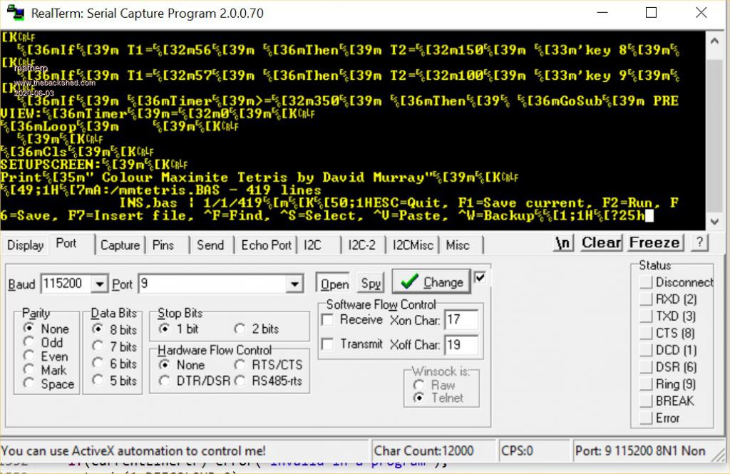

Posts: 12083
Posted: 02:09pm 02 Jun 2020
Tested locally with realterm there are definitely no extra characters or hanging escape codes. The last thing sent is esc[?25h to turn the cursor on.
It may be TCP/IP is somehow padding?
The code does not attempt to resize the window as there is no reason to. The intention is just to ensure there is a window big enough to use once and for all.
Posts: 2552
Posted: 02:50pm 02 Jun 2020
am i not seeing ddouble?
rob   :-)
Posts: 4391
Posted: 03:16pm 02 Jun 2020
I'm seeing it, too.
Posts: 12083
Posted: 03:20pm 02 Jun 2020
I though you meant at the end. I'll remove that one in the next release but should be benign: certainly is in Teraterm and Putty. What is categorically not the case is any padding at the end of the page update
Posts: 2552
Posted: 03:48pm 02 Jun 2020
the padding was at the very end of the file, try paging down to the end and check. it could well be that the a:/fm.bas file sitting on Jim's CMM2 has padding in the file itself from an earlier x-modem transfer.
try creating a short file with some text followed by a a whole load of control-Z characters at the end, then load it into the CMM2's editor. when loading a file into the editor, control characters like tab, cr and lf should be handled sanely*, other skipped, and upon seeing the first control-Z loading should terminate - just like what happens with AUTOSAVE on the micromite.

Posts: 12083
Posted: 03:50pm 02 Jun 2020
All Xmodem transferred files have padding at the end. This is nothing to do with the CMM2. This happens on all MM but most terminals don't show it

Posts: 6632
Posted: 09:38pm 02 Jun 2020
All XMODEM transfers will pad the file with either ^Z or chr$(0) characters.
There has never been any consensus on which to use.
The file FM.BAS was transferred to the CMM2 using XMODEM so has the padding.
This is one reason why I usually use AUTOSAVE to transfer code but I did have to test XMODEM sometime.
Posts: 2552
Posted: 04:10am 03 Jun 2020
aha, that explains what i saw. i'd consider the editor reading in those control characters verbatim to be a bug - once a file is loaded ALL control characters should be absent from the editable text.
