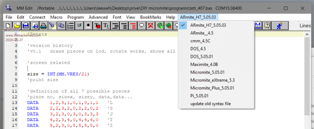

Has the program been transferred to the mite successfully?
You will have problems if you haven't selected a suitable syntax file.
LIST it to check.
You can also transfer the program form the chat window using the "Load" button
You still need the correct syntax file in use for it to work.

The syntax file TassyJim refers to refers to a configuration of micromite/maximite type you have connected, and version of the firmware. You can select the correct type in MMedit.

As I said on the first row of the post, I am running "Micromite MKII MMBasic Ver 5.05.02", on a PC with WIN10.
So which Micromite do I select for this version?, because V5.05.02 does not show up under Syntax??

As long as you have Micromite selected, it will be OK
Different devices such as Armite or Maximite work differently. That is why we need to tell MMEdit what device we have connected. There are no differences between firmware version on the same device.
