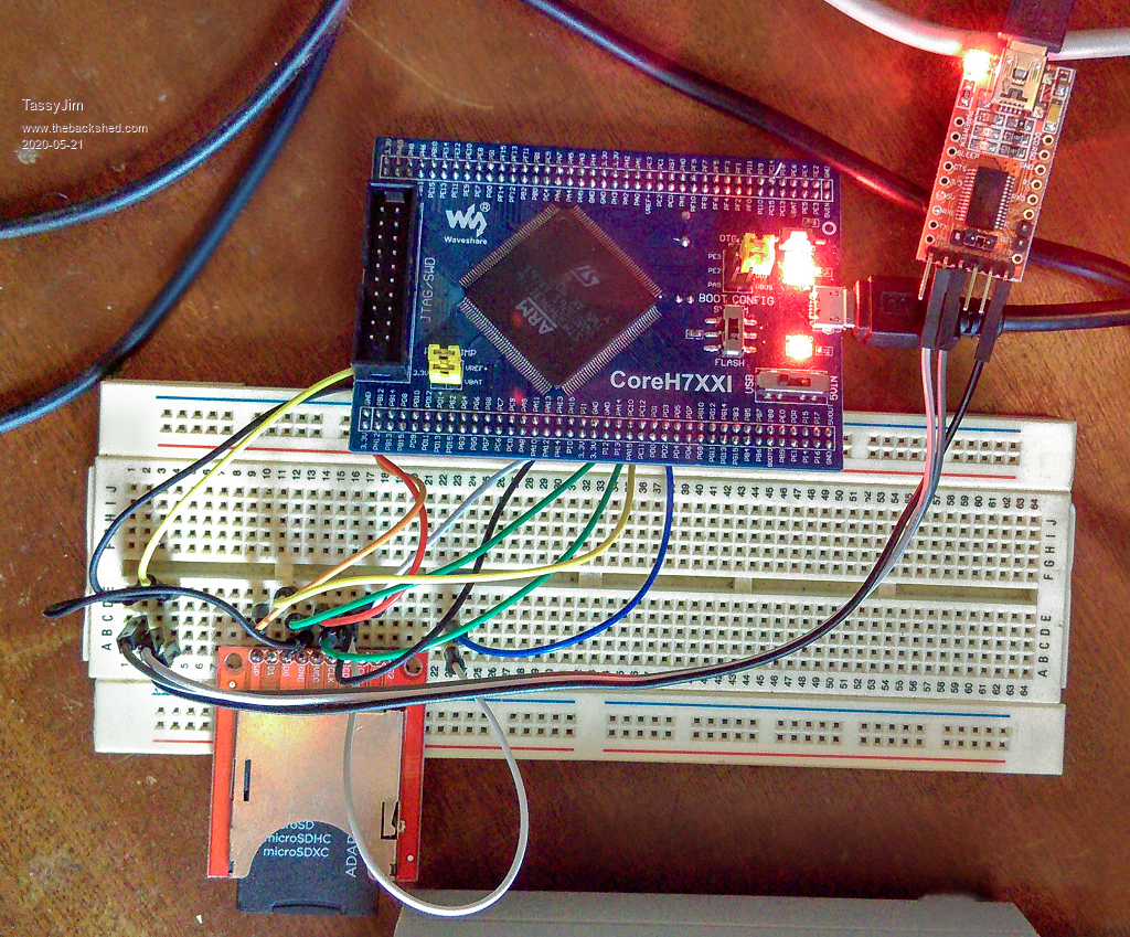

Do you have the 2mm 80x2 headers for the module?
Without any of them, there is not much you can do.
If you have spare headers, you can wire up a SDcard holder and with any old USB-TTL module, you can get on air although without any display.
My headers came before my board so that is what I did and the unit I have on the net is still built that way.
