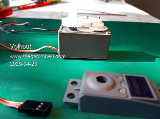

This picture shows a cheap RC servo, when the gearbox is opened.
A close up of the gearbox. This gear arrangement is typical for many RC servo's.
This gear is the one that is key to this implementation. It is dome shaped.

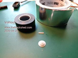

We need these materials of change the gear into an optical encoder wheel.
First we put a strip of reflective aluminum tape around the dome, and then apply small pieces of black isolation tape in a regular pattern. I applied 4 at 90 degrees angle, but 8 or 16 can also be done.

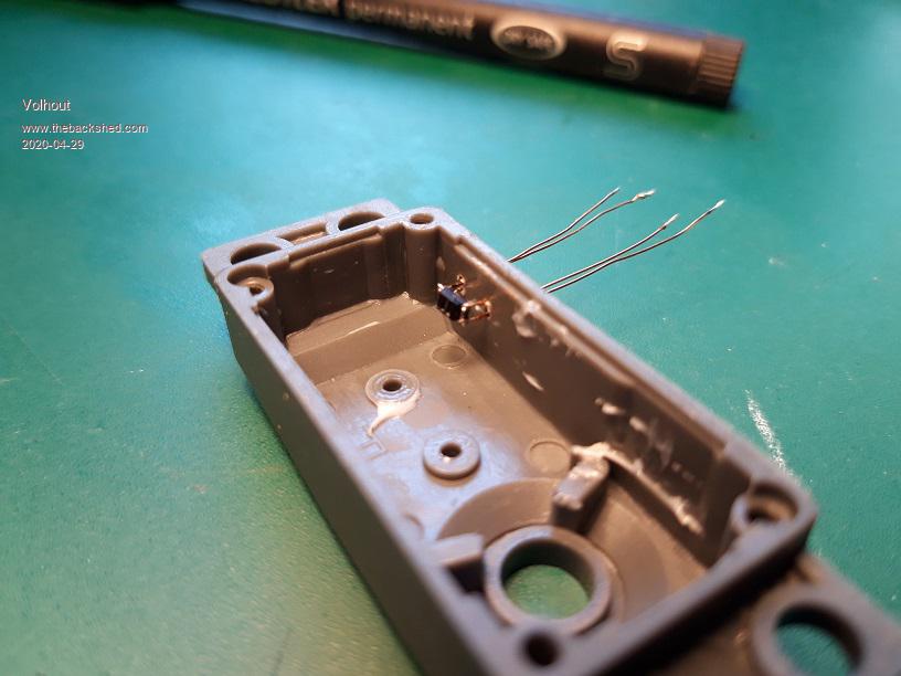

The optical reflection sensor used has a focal distance of 0.5mm. This one is a SMT part, and I had to add wires. There exist similar sensors with pins. That makes life easier.
4 wires soldered to the sensor
in the gearbox cover 4 small holes (0.8mm) are drilled and the wires are pulled through. The sensor is roughly positioned, but can be moved through the wires.
Put the gearbox cover back on and push the wires inward until the sensor touches the dome gear (the encode wheel), mark the position, and pull the wires out 0.5mm.
Then apply glue to the wires/housing to fix them.

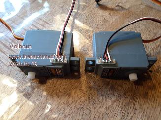

Glue a piece of veroboard to the servo cover as a strain relief, and solder the 4 wires to that.
2 servo's modified, note that one is mirrored, so the servo's can be used to drive wheels of a robot without the sensor wires being exposed.
