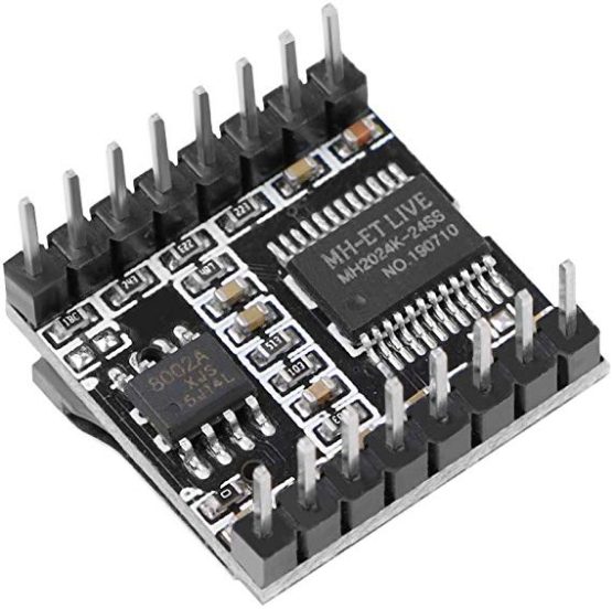

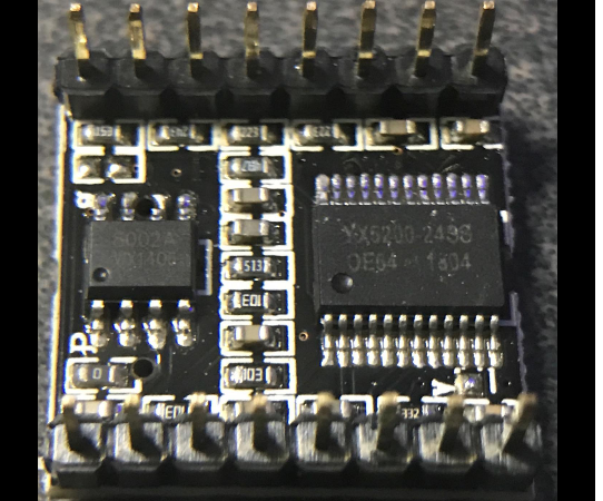

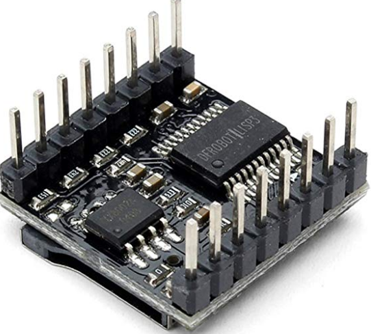

I have been looking in to a screen-less controller using a motion detector to pickup
a body near by then announce the current data with a few capacitive touch pads to
adjust the settings. So I saw what was being done here on The Back Shed and started
looking at these modules. Sad to say it's game of roulette on being sure any batch
is good even when the pictures show the right part. Lucky amazon does get refunds
on miss represented items. Just be sure the description has the right part number
in it to ensure a refund.
I was going to just add the links but then the information would be scattered
 so here is some reviews with usable information from amazon buyers over the
 last few years.
From an Amazon May 2018 Review
There are a lot of vendors out there selling these "DFPlayer" boards. I bought two sets of five from this particular vendor and all of the ones they sold us do not work with setups/code that do work with this type of board I got from other vendors. It seems that it boils down to the actual chip they are using. These are not the YX5200-24SS marked chips which actually have a datasheet and which you'll find on a lot of boards. These are some knockoff chip/or another run or something that say MH2024K-24SS on them (many with worn-out ink/printing). They also have MH-ET-LIVE printed across them...again highly variable in quality. Without speculating too much, maybe these are counterfeits or clones or busted chips that were bought/taken from a fab house and relabeled? I'm honestly not sure what MH-ET-LIVE is...google has some links but it just seems like some random hobby-electronics rebrander with little-to-no-documentation. Anyways I have no idea, but after spending quite a bit of time try to ring these chips out and comparing how a properly I've had no luck. They are all bricks (they draw some reasonable current...but do not respond to serial data that I know YX5200 series do, so I'm sort of at a loss. Every other component on these boards is identical to working boards so it is the chip...maybe this type of chip works normally and I got 10 out of 10 bad ones ? Maybe this isn't even a real chip and someone is just offloading a bunch of junk somewhere along the parts pipeline. Regardless, I have ten boards that are useless now. They are not mutually interchangeable and have no documentation at all online so are pretty much useless junk. Waste of money and very frustrating. The price is clearly cheap for this reason. I do a lot of large-scale development so I can handle debugging stuff like this, but it is frustrating when a vendor is selling junk like this and some kid will buy it and have no point of reference for why it is/isn't working.
From an Amazon Dec 2019 Review
Ordered the DF Player mini from this listing "Anmbest 5PCS YX5200 DFPlayer Mini MP3 Player Module MP3 Voice Decode Board Supporting TF Card U-Disk IO/Serial Port/AD for Arduino"
I received a mp3-tf-16p module. These are not the same though they do the same thing. I spent time spinning my wheels trying to find out why my code wasn't working, I mean it's not rocket science. I have a DF Player mini and had coded for that and everything worked great. Once I received this module and swapped it out it no longer worked. turns out you need to delay after calling begin on the library and call begin again - probably because of some initialization time on the mp3-tf-16p chip. At any rate, I should have received the advertised product and wouldn't have had to go through all this. If you are the seller and are reading this: if you didn't know that you weren't providing as advertised please update your photos and be clear about what it is you are selling. if you did know this, shame on you
From an Amazon April 2018 Review
So when these boards ship with a chip marked YX5200-24SS they work really well. In the last month, however, a lot of vendors (including this one) seem be selling these boards with chips marked "MH-ET-LIVE MH2024K-24SS", and these do not seem to be interchangeable. If you are having trouble getting these boards working, check the chip number. I'm not sure if these are counterfeits or some different run of the chip or a completely different device altogether, but I cannot get these type of boards to work reliably with 3.3V devices anyways. I have not rigorously tested them, but please be aware of this.
From an Amazon Feb 2019 Review
The picture shows YX5200-24SS. I got a JC? AA1828CJ5M2U.1-94 instead. I think JC stands for "Just Crap".
It's mostly the same as a DfPlayer Mini, but not quite. You need a 1K ohm resistor on both the Tx AND Rx interfaces for some reason. Other people suggested connecting BOTH grounds on the Df module too. Mine doesn't seem to work when the arduino is powered via the PC, but will work if I just power the board from a USB charger directly. This has wasted tons of my time debugging, and it is still not very reliable as far as I'm concerned.
Some pic's of the boards reviewed.
From sellers images so who knows good/bad/other wise
I hope this information gleamed from others help here.

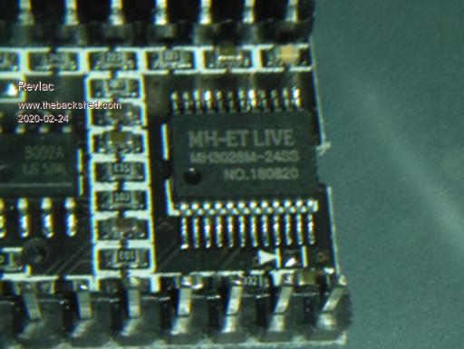

After reading this and the info about the fakes, thought I would check the ones I bought and saw this in the chip MH-ET LIVE MH3028M-24SS.
So now I'm confused.
Bought these for a model railway project to add sound to some parts of the layout, was thinking about using it for loco sound loops but that would be too limited, so on to the next idea for that.
Have not seen another of these DFPlayers with this MH3028M-24SS chip.
Cheers Aaron

  Revlac said  After reading this and the info about the fakes, thought I would check the ones I bought and saw this in the chip MH-ET LIVE MH3028M-24SS.

@ cosmic frog: "I can only find them on Aliexpress and don't really trust them anymore." - Really?!  I use AliExpress all the time, and I actually prefer them to eBay most of the time, cos you can choose from various shipping options on most of the AE listings, so I find stuff comes to me faster from AE then eBay.  Oh well.  I could get in some 5200 chips if you like, then send some to you if you wanted to try that?
@ Revlac(& also cosmic frog): Yes, I would be interested if the 3028 responds to serial.  It is possible that 2028 is buttons only, and the 3038 might be serial and buttons.  Who can say.  I cannot find any useful information about the MH series.

Have not tried it yet, its in the endless list of things to do, will update when I get it together.
Already have most of the parts and there is a Nano somewhere on the table and will give it a run
Got this one from Ebay and the seller no longer stocks them...whats new.
I was going to ask if there are any other module that has similar functions to these?
When I look up MH3028M There are pictures of a different module, eg. Aideepen YX5300 UART Control Serial MP3 Music Player Module for Arduino/AVR/ARM/PIC
It looks more serial orientated, so I'm thinking it would work.

I can confirm the module labelled MP3-TF-18P with a MH3028M-24SS chip does work with the serial interface.  I have another module labelled DFPlayer-Mini with a chip marked as AA1752CJ3J13.1-94 and that also works with a serial interface (both 9600, 8n1).
Gerry

It would seem then, that perhaps the 2028 chip is simply button-only, and no serial support?

Tested using a nano and DFPlayerMini_Fast-master, the DFPlayer with this MH3028M-24SS chip works nicely with serial, the wav or mp3 files, last one saved to the micro SD was the first one to play.
Also it was a bit fussy about the file names, it refused to play 01 (ended up corrupting the file) but 001 or was it 0001 works fine.
There was some explanation about this in the DFPlayerMini_Fast file.
Obviously I'm new to this, but I have it the player doing what I want it to. eg. play first track then loop second track.
perhaps the 2028 chip wants the correct file names.
