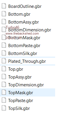

In the CN column of the January issue of Silicon Chip in there was a description of a ‘Micromite Mk2 dev board with Microbridge’. I wanted to get a couple of boards so I downloaded the ZIP file which contains the Eagle ECAD files and Gerber files among other things with a view to ordering 5 boards from a Chinese manufacturer like: JLCPCB, PCBGOGO, PCBWay or similar.
From what I understand a drill file is needed to specify the drilling sizes. But there is not one included. The Gerber files included are:
I had a look at some of the Gerber files and the first line says:
G04 DipTrace 3.3.1.3*
Which leads me to believe that they were created using Diptrace NOT Eagle. I use Diptrace 3.3.1.3 for schematics myself so I imported the .brd and .sch files into Diptrace and produced a new set of Gerber files as above and a ‘Through.drl’ file. It’s a bit of a worry because the new set of Gerber files are different to the originals.
My problem is: are the original set of Gerber files enough for ordering PCBs? Or should I use the second set even though they are different along with the .drl file. How do I supply them to the manufacturer?
