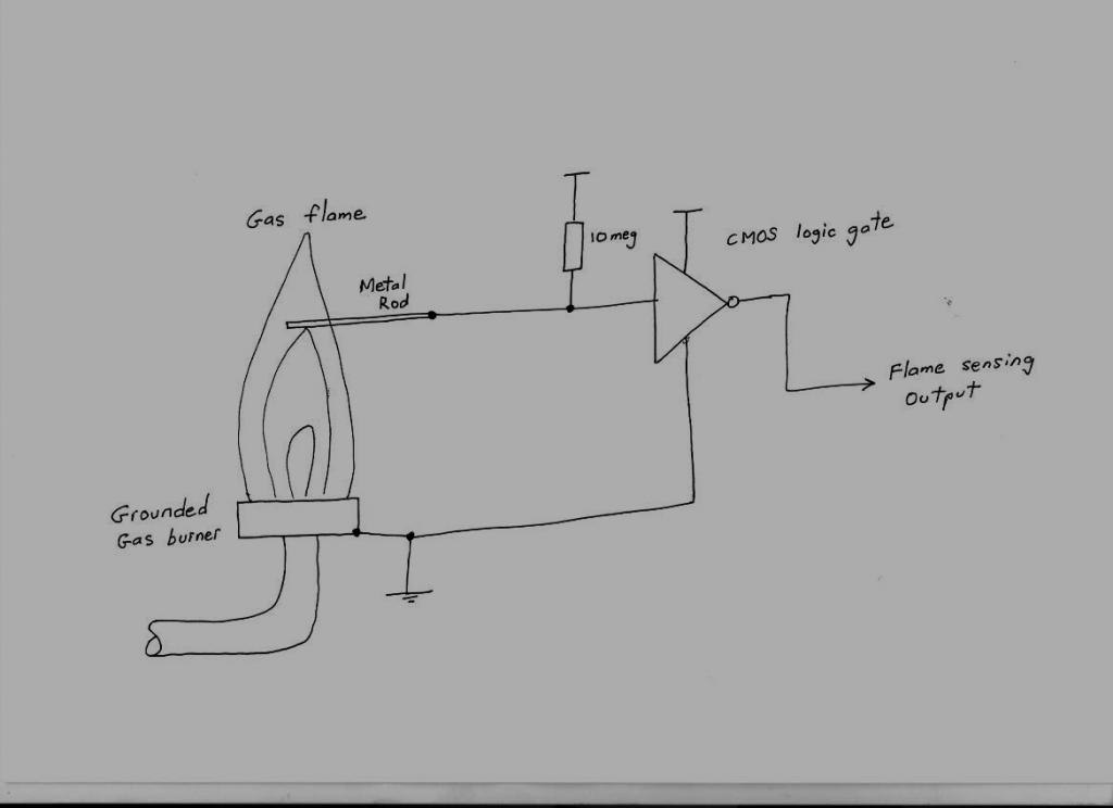

Posted: 12:01am 18 Sep 2019
There is a much easier way.
The plasma in a burning flame is electrically conductive. All you need is a metal electrode poking into the flame, a very high resistance pullup resistor and a cmos logic gate.
Logic high, no flame, logic low flame present. You will need a good quality stainless steel electrode that won't burn away, and a ceramic insulator to support it.
The spark igniter electrodes used in gas stoves are available on e-bay, and would be ideal. This is just one example:
https://www.ebay.com.au/itm/Gas-Grill-Ceramic-Igniter-Electrode-Pin-Spark-Ignition-Cable-400mm-For-Heater/163650519219?ssPageName=STRK%3AMEBIDX%3AIT&_trksid=p2060353.m2749.l2649
But to just experiment with initially, a nail or piece of steel wire will work just as well, for a short time anyway.
This electronic flame sensor method is used in most types of modern automatic gas appliances these days, and is usually connected to a microcontroller that controls the spark ignition, and gas valve.

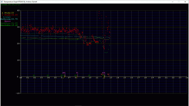

Because I had some, and it was easy, I put a DS18B20 probe just into the HWS flue (exposed to both exhaust gases and ambient air flow).
A simple MM170 circuit uses an HC-12 to show the temperature every minute on my PC (and every 15 seconds on an LCD BackPack).
In this image the HWS plot is in red, the two green tracks are external air temperature (every 10 minutes).
Some observations:
- there is a lot of scatter in the 1 minute readings - WHY? My other (green) temperature sensors are more sheltered and may be less effected by wind. There is no averaging employed.
- my HWS is sick, it sometimes doesn't fire up despite a long shower (at about 10:00) (confirmed by the pilot being out). That little rise just after 10:00 is more to do with ambient temperature - not the HWS. When I lit it (about 11:10) the displayed temperature shot up to above 40degC (off the plot) and came back down before 12:00.
- just after 12:00 there was a second shower and the HWS fired up (as it should) to just over 40 (off scale). This means it sometimes works. Its temperature tailed off after about 12:15.
- I am surprised how quickly it heats the water after a shower!
I can thus detect when it is on (ie when it is above say 35 and ambient isn't) vs off (ie when it is closer to ambient).
I have another possible option. Before embarking on this "project" I replaced the thermocouple (which I now suspect was OK). My DMM shows a change in resistance when I heat it (but I cannot trust the reading as it sometimes shows a negative value) - can I place that nearer the gas ring and get a more direct measure. How would the circuit look?
(Beginner's question I know, but, how does the HWS use a change in resistance on the thermocouple to sense heat when there is no power source to the HWS?)
