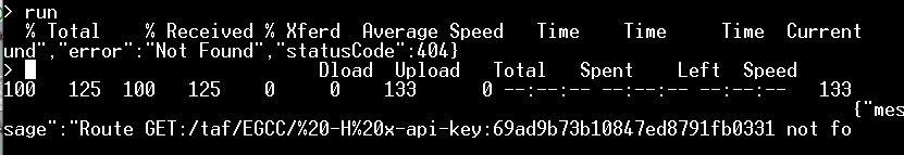

Joined: 23/12/2015
Posts: 1709
Posted: 09:36am 29 Nov 2020
Close
system "curl "+q$+"https://api.CHECKWX.com/taf/EGCC/ -H x-api-key:69ad9b73b10847ed8791fb0331"+q$,c()
gives
system "curl "+q$+"https://api.CHECKWX.com/taf/EGCC/ -H x-api-key:69ad9b73b10847ed8791fb0331"+q$+" -m 60 -s -S",c()
gives
EDIT: I think system "curl "+q$+"https://api.CHECKWX.com/taf/EGCC/ -H x-api-key:69ad9b73b10847ed8791fb0331"+q$+" -m 60 -s -S",c() didn't work is because
x-api-key:69ad9b73b10847ed8791fb0331 has to be "x-api-key:69ad9b73b10847ed8791fb0331"
Edited 2020-11-29 19:41 by lew247

I've just tested it using terminal to the PI from Windows and
curl https://api.CHECKWX.com/taf/EGCC/ -H  x-api-key:69ad9b73b10847ed8791fb0331  works
system "curl https://api.CHECKWX.com/taf/EGCC/ -H  x-api-key:69ad9b73b10847ed8791fb0331"+q$,c() results in
I need a way to pass the spaces in the address through the system command "%20" doesn't work
and using %20 results in
Edited 2020-11-29 21:26 by lew247
