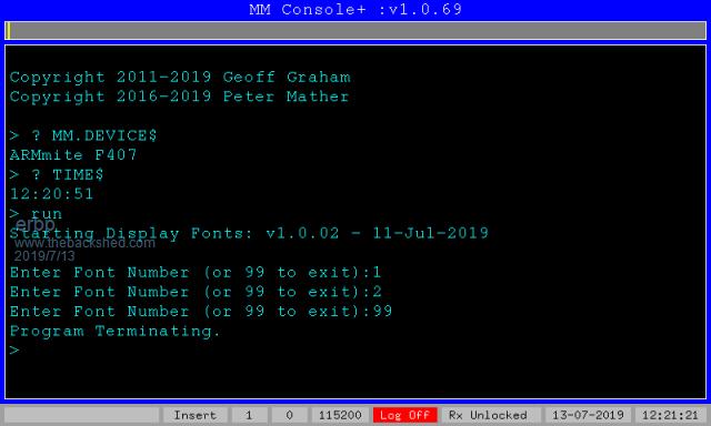

Below is a screen shot of one of the main screens of MMConsole+ acting as the console for a connected ARMmite F4 and running a few commands, including initiating a program that I had just uploaded to the F4 via MMConsole+.
