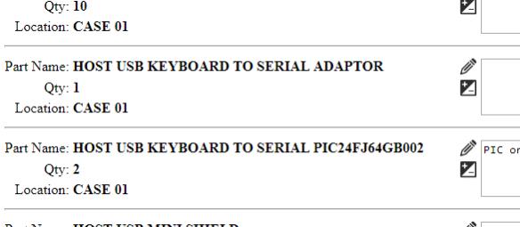

EDIT: According to my DB, I have one in stock and two pre-programmed PICs:
so if you get really stuck we could probably come to an arrangement.
