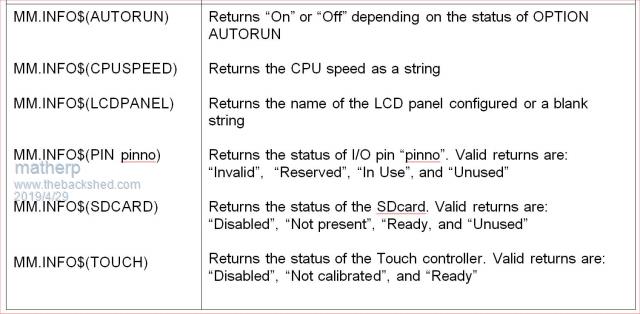

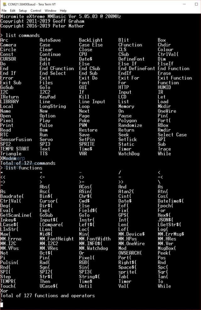

This version includes mp3 playback over the I2S output port as well as flac file playback. It also includes a new information function MM.INFO$() as well as "LIST FUNCTIONS" and "LIST COMMANDS"
