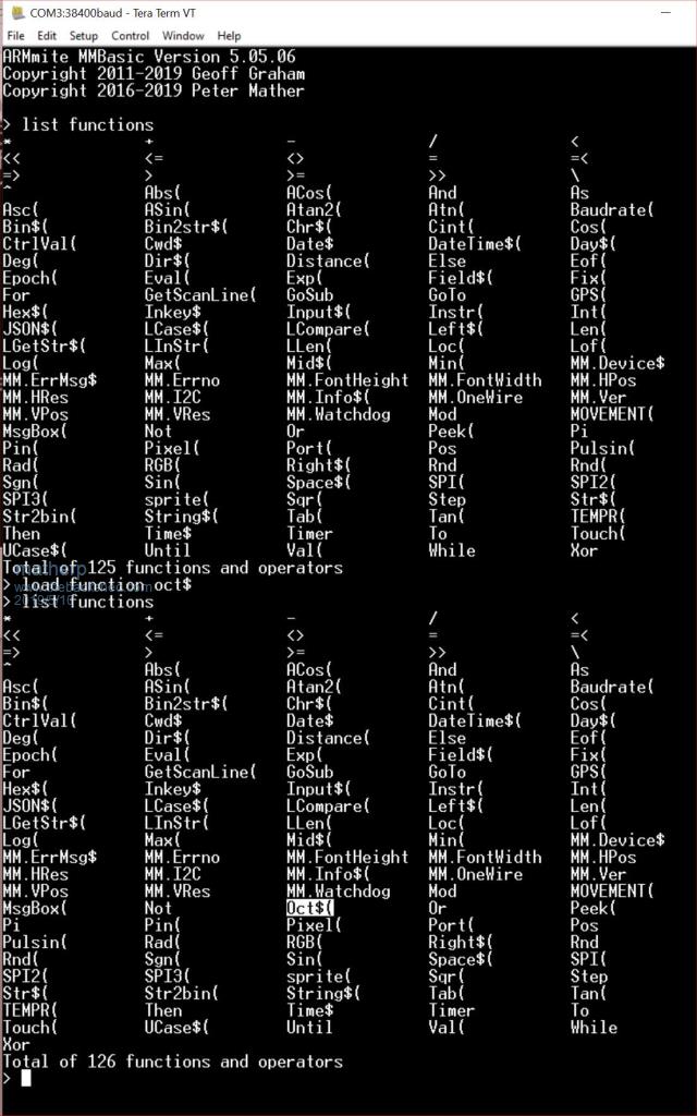

LIST COMMANDS will list all valid ArmmiteH7 commands
LIST FUNCTIONS will list all valid ArmmiteH7 functions and operators

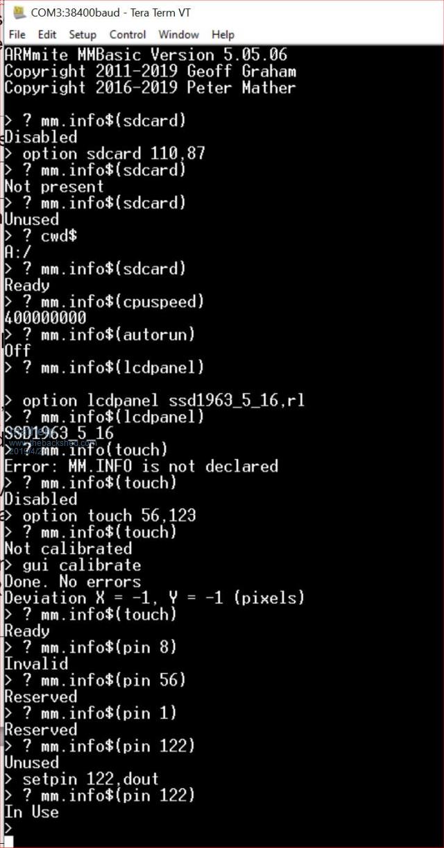

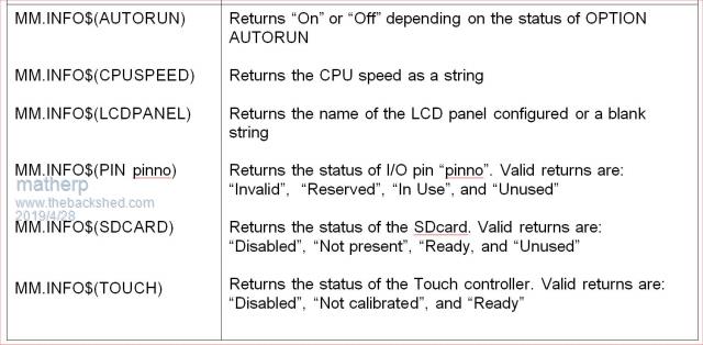

Posted: 03:09pm 27 Apr 2019
Minor addition of an information function. I'll add this to other ports as and when.

  Quote  Just curious - the current output of the "list commands" and "list functions" on the v5.05.06 H7 code shows 127 of each. I thought the current limit was 128 functions & commands - how do you add 2 extra functions?
I'm going to have to cull a couple of the lesser used functions - no decision on what yet.

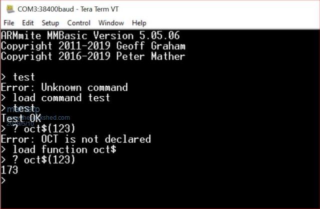

Posts: 12083
Posted: 02:00pm 08 May 2019
Update to 5.05.06 that includes BIN2STR$() and STR2BIN(). Also fixes problem with SSD1963_5_8BIT driver and a bug when using VAR save with large arrays
2019-05-08_235659_Armmite1.3.zip
2019-05-08_235733_Armmite_H7_Manual.pdf
Functions removed:
SPC(): already marked as obsolete by Geoff - use SPACE$()
MM.I2C2: use MM.I2C instead, this will be updated after any I2C or I2C2 command

Try this:
2019-05-10_231917_Armmite1.3.zip
I've also solved the number of functions and commands issue
I'll make many of "my" commands and functions loadable and that way users can select which they need for a specific application.
The LOAD FUNCTION and LOAD COMMAND commands cannot be used in a program for obvious reasons, but they can be put in MM.STARTUP so that they are set up as part of boot sequence and are then immediately available for use.
There is no performance impact of this approach
Edited by matherp 2019-05-12

That solution works well (just tested it!).
Looking forward to the manual update with the list of "optional" functions and commands.
Will there still be limit of 127 functions/commands even with this approach? By that I mean are we only able to load an extra couple of commands/functions or is it able to support any number of extras?
