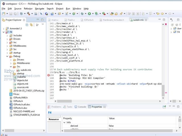

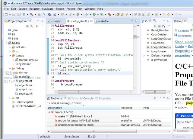

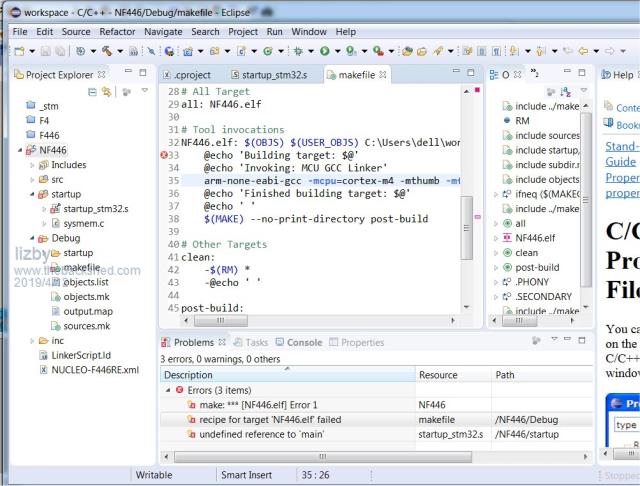

Still stuck--or stuck again. For a time it was a project which did not have the little "C" mark on the project icon, and so had no "C/C++ Build" or "C/C++ Properties" in Project Properties. After failing to figure out out to make it a C project, I started over today, generating the project code from CubeMX and making a C project.
Now I have the "C" mark on a new project and set the properties as suggested and copied in the Src and Inc files. I get three failures after trying to build (or perhaps it's one failure which cascaded).
Here are screenshots:
There are differences between the two files shown above and the corresponding files in the H7 project, but I don't know enough to tell whether they are significant.
Any ideas?
